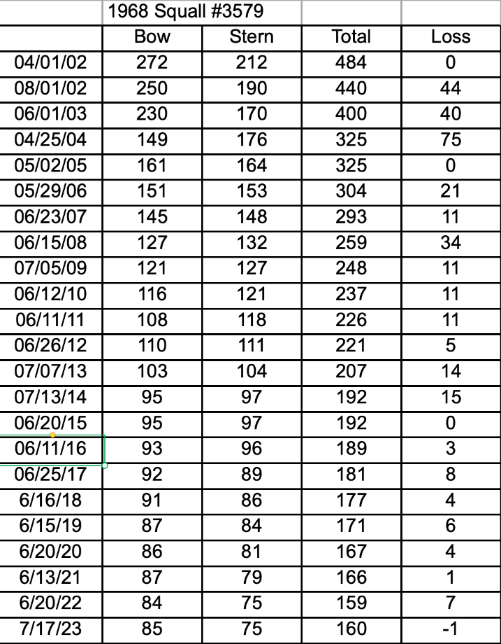

This Unibond hull drying out process goes back 21 years: de-water-logging my 1968 SQUALL started in southeast Alaska.
Fig. 1.
Screen Shot 2023-07-17 at 4.35.03 PM.png (176.63 KiB) Viewed 3709 times

Hi Jim—thanks for the update.
Q1: has the time come to patch the holes and put that SQUALL in the water?

JimH -
Good question! If I keep drying her out it gives me an excuse to sweep out the garage each year!
