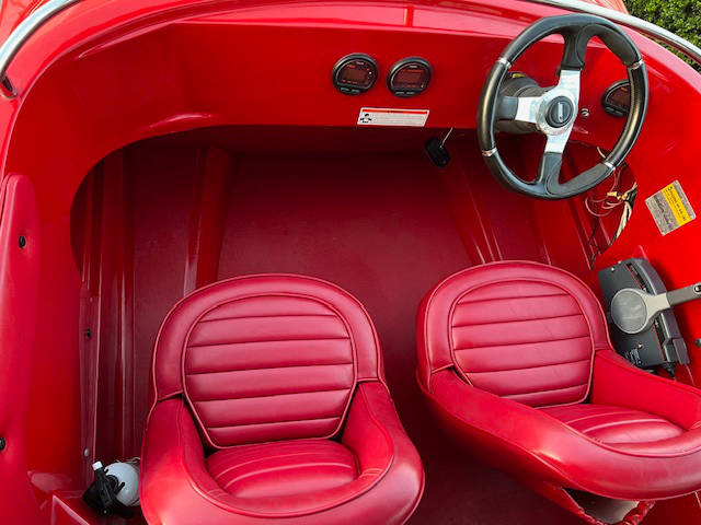

Fig. 1. Overhead view of the cockpit and seating of a MISCHIEF 15 with red gel coat an uphostery.

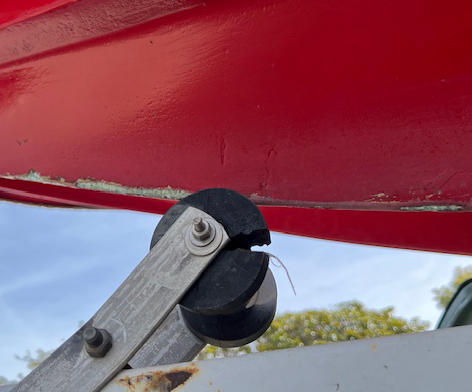

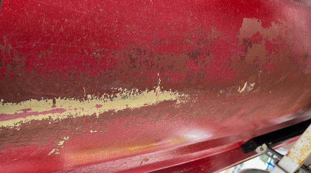

[The wearing-off of the gel coat] maybe due to beaching, or normal wear. See illustrations below.
Fig. 2. Hull bottom showing numerous layers of different colors.
Fig. 3. Keel rash at the bow.

There are so many layers of different colors seen in Figure 2 that I suspect that the current glossy red color is a paint top coat, not gel coat resin. There appears to be a dull red layer below the bright glossy red layer which might be the original gel coat layer, now very dull and oxidized, and then a yellow layer below that which could be some of the original hull layup resin. The is also possibly some old bottom paint layer appearing here and there.
If this were my boat, I would begin to investigate how many layers of different color exist on the hull. To do that I would begin wet sanding on a layer of the glossy red finish in an inconspicuous area, and observe how many layers I had to sand off until I get to the basic fiberglass layer, which should be a bit of a greenish white.
The abrasion of the keel seen in Figure 3 may be in part due to the broken roller seen in the same illustration or from abrasion or striking something very hard like part of the trailer steel. This area looks like pieces have chipped off, and the basic laminate layer is now exposed to water. The basic laminate layers which were under the gel coat are not water resistant. This damage needs to be repaired soon before water gets into the laminate layers.

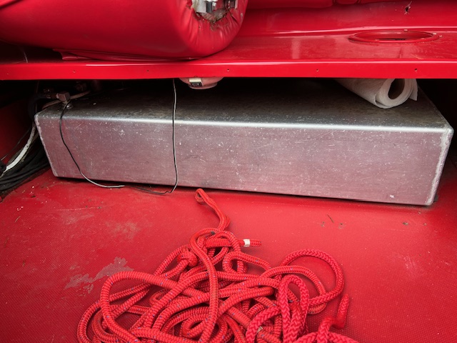

Fig. 5. An aluminum fuel tank.
The fuel tank on my MISCHIEF is aluminum.
Q7: was an aluminum fuel tank an OEM option?

MisChief15 wrote:Q7: was an aluminum fuel tank an OEM option?
Most dealers rigged a MISCHIEF with portable 6-gallon fuel tank (or tanks) with fittings matched to the engine the dealer installed.
[The aluminum tank on this MISCHIEF] is an after market tank. A full tank will weigh a fair bit more than the battery you are planning to move. For weight and balance concerns, it may likely be easier and simpler to move the fuel tank to the bow side of the divider panel which sits just aft of what would be the anchor locker on a standard 15 hull. If it works to your liking, you could later add a through-deck fuel fill fitting.
