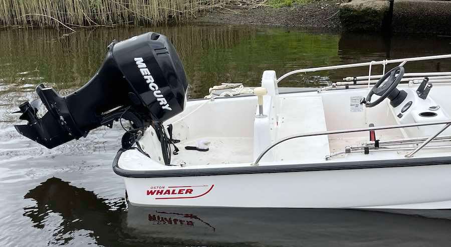

Based on the view seen in Figure 1 below, is the static trim of the 2006 130 indicative of having water in the stern?
Fig. 1. A 2006 130 SPORT at static trim.
Note that the water is about an inch or two above the waterline.

A good indicator of the static trim of any Boston Whaler boat is the position of the engine splash well drains relative to the static waterline with no one aboard. Typically the drains of the engine splash well should be above the waterline or just at the water line. Engine splash well drains that are totally immersed below the water line at static trim are generally indicative of too much weight in the stern of the boat.
For any cockpit sump area to fill with some seawater when the cockpit sump drain fitting is removed and the drain is open to the sea is open is completely normal. However, if the water rises in the cockpit sump and begins to flood the deck of the cockpit, that is another indication of too much weight in the stern. If the flooding is limited to a very small area of the cockpit, this may be a normal situation in some models with certain engines.

I don't understand your remark. The water is at the water line.
Perhaps you meant to say that the waterline at the stern in static trim is higher than the waterline suggested by where the boat bottom paint was applied.

jimh wrote:Perhaps you meant to say that the waterline at the stern in static trim is higher than the waterline suggested by where the boat bottom paint was applied.
Yes.
The painted waterline around the stern is sitting below the surface of the water. I assumed the painted waterline was correct at some point in the boat's past. The guys who re-painted this year followed the same line.

Most of the model year 2000 through 2008 130 SPORT boats tend to list to starboard. It's normal.
The early 130 SPORT boats originally had two-stroke-power-cycle engines that were much lighter than your Mercury FOURSTROKE. Most 130 SPORT boats with a four-stroke-power-cycle engine tend to be stern heavy.
[Other influences on the static trim on a 130 SPORT are the ] location of the battery and fuel tank, and what volume of fuel is aboard.
The 130 SPORT is a great boat. The 130 SPORT ride is much better than the older classic 13-footers.
The model year 2000 130' SPORT only had a 30-HP engine, and having a 40-HP engine was a welcome addition.

frontier wrote:The early 130 SPORT boats originally had two-stroke-power-cycle engines that were much lighter than your Mercury FOURSTROKE.
That would explain how the present static trim at the stern is much lower than where the original waterline was painted for the bottom paint.
All small boats are very sensitive to weight and its placement on the boat.
If the 130 SPORT is going to be left in the water for more than a few days at a time, the anti-fouling paint should be redone so that the present waterline is reflected in the bottom paint waterline.

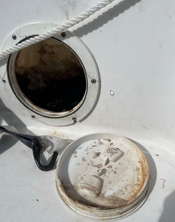

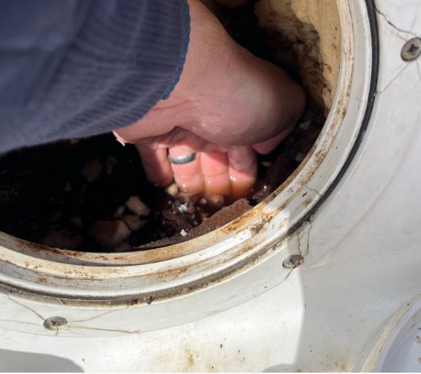

Thanks for your very thorough assessment. Yeah have been trying to look around the marina at other whalers but no 130s around. I would love it if it were just the engine weight and trying to stay positive but here is what we saw yesterday when I opened the access point, which seems to indicate additional water weight. About 2.5-2in of water there and I know they had pumped out the little bit that had been there when they sealed the ladder bolt and serviced the engine, a week ago. What I also noticed was on the cap you can see from the stain that at some point there was a lot of standing water for a period of time. :(

frontier wrote:Most of the model year 2000 through 2008 130 SPORT boats tend to list to starboard. It's normal.
Typically the engine starting battery is located on the starboard side of the transom area on most outboard engine-powered boats. That weight causes the bias for the boat at rest to have a slight list to starboard.
For the same reason, on a Boston Whaler boat the cockpit sump is located to starboard. The list to starboard causes free water on the deck to drain into the cockpit sump on starboard.
