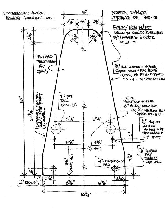

I think you will have better luck fabricating a bow pulpit out of wood. You can use the Revenge/Outrage 25 bow pulpits for reference.
I just so happen to have a measured drawing. Not sure how/why I have it.
Drawn by Larry Goltz.

[Updated] I suspect that the drawing from Larry was for his classic-era OUTRAGE 25, I don't recall the model year but it was certainly NOT 1993.
However, the general shape and dimensions of the OUTRAGE 25 wood pulpit may be useful for making one for a 1993 OUTRAGE 21. The wood bow pulpit was often an optional item on classic era Boston Whaler OUTRAGE models.

The drawn pulpit is about 17 x 30 x 1.5 inches. I assume it is a laminated piece as finding a solid piece of teak in that dimension would be difficult and expensive and generate a lot of waste.
