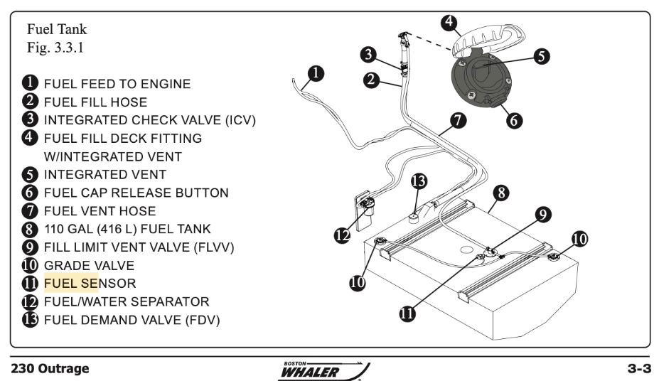

Have you reviewed the owners manual for the engine(s) and the boat"?
Page 3-3 from the 2024 Outrage 230 Owner's Manual.
Item # 12
[The fuel-water separating filter] appears to be mounted on the forward wall adjacent to the raw water pump. I drew a circle to its approximate location.
Item # 12

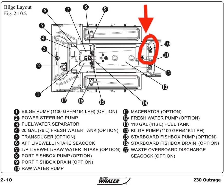

CALLOUT 3 identifies the fuel-water separator in Figure 2 above. Because CALLOUT 9 refers to the item as being on Port, the inference is the drawing is oriented with the stern of the boat to the left. This suggests that the fuel-water separator is attached inboard of the transom. But in Figure 1 the fuel filter appears to be located forward of the fuel tank, which conflicts with what Figure 2 shows.

Re: 2024 230 OUTRAGE Fuel-Water Separating Canister Filter Location
Jim - Your terminology is confusing.
It the first diagram, labelled Fig 3.1.1 the view of the illustration is from the port stern quarter.
The second diagram, labelled Fig 2.10.2 the view of the illustration is from above with "port" being on the top and starboard on the bottom.
The filter is on the forward wall of the tank cavity, on the port side.
Phil—please explain in Fig. 2 where CALLOUT 3—the fuel water separator filter—is located.
You have circled CALLOUT 10, the raw water pump.
I have circled the area of the forward wall. Item 10 happens to be located adjacent.
Q4: What about CALLOUT 3?
Water Seperator is located under the most rear deckside hatch, center of the deck, mounted on the interior side of the transom. You can't miss it.
Oh cripes. (rated G comment)
Yes, it's on the aft wall. Diagram Figure 3.3.1 is incorrect.
The draftsman of these figures is a idiot who needs retraining on understanding fore and aft, port and starboard.
PHIL--I don't understand why the device indicated as CALL OUT 3 as shown in Figure 2 in this discussion (which was taken from a Boston Whaler manual where it is identified as FIgure 2.10.2) is not the mysterious, invisible fuel-water separating filter that is being sought?
I am sure the left side of the drawing (in Figure 2) is the boat transom, as that must be inferred from the location of the SONAR transducer (optional) at CALL OUT 5.
Also the electric-hydraulic power steering boost pump, CALL OUT 2, is located there, which makes perfect sense that this is the transom area.

Final Comment: Went to my dealer and completed a walk through with boat manual in hand. My 2024 230 OUTRAGE does not have a separate fuel-water-separating canister-type filter installed—regardless of the owner’s manual documentation. The only protection I have from water in fuel is the fuel filter which contains a water sensor.
As noted comments, I may need to check to see if I added one if it would impeded or impact thr fuel flow to the engine.
Again, I want to thank those that commented.
