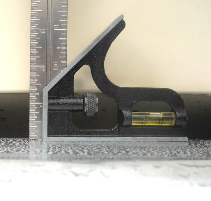

Fig. 1. Clearance between hull chine and trailer fender of 1.25-inches, for 22-foot hull on 102-inch-wide trailer. The hull has a specified beam of 7-feet 5-inches (89-inches).
Generally the lower the hull can be positioned on the trailer to be above the fenders, the better. A clearance of 1-inch is about the limit.
The position of the keel rollers and the support bunks will determine the height that the hull is carried on the trailer frame, and those supports are adjusted to bring the hull chines as close to the fenders are possible, again, about one inch.
