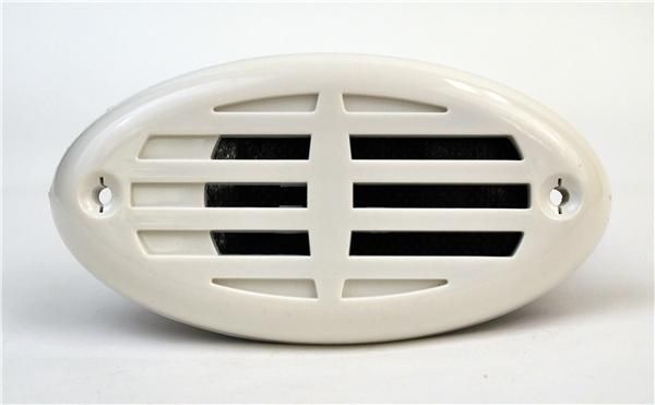

The typical horn I have seen looks something like this one:
Fig. 1. ATTWOOD Low Profile 12-Volt Boat Horn, $41
Cf.: https://www.easternmarine.com/boat-horn-114787
By the way, I picked ATTWOOD because ATTWOOD is just a operating segment of Brunswick, much like Boston Whaler.
