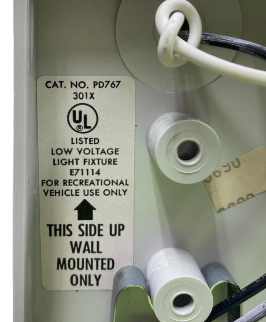

When looking for a replacement for the cabin 12-Volt reading lamp in my 1989 REVENGE, I found a label on the back mounting plate of the lamp that identified it as model "UL PD767." Searching for that term I found a seller on eBay at

Fig. 2. Rear panel view showing Cat. No. PD767

Out of curiousity I unmounted the lamp on my REVENGE to inspect the back side. There I found the same label as shown above in Figure 2.
