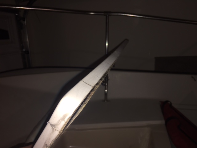

The bow locker is splitting along the corner and there is some cracking on the sides and top. Any thoughts on how to get this back together for good? I assume the cracking would be handled the same way with the Loc-tite for now and grind and gelcoat in the fall.

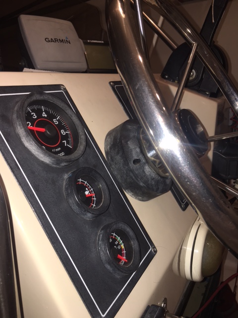

3. The gauge plate and dials are pretty dried out. How do I make them shine like new?

I assume the bow [laminated hatch cover] is hollow. Do I apply 5200 around the edges and put a weight on it [until the 5200] cures?

The bow locker laminated cover can be repaired with epoxy resin with some thickener. Tint the epoxy to an off white. It looks like the repair area will not show when the hatch is closed, so you won't have to get a perfect match.
I have never heard of Loc-Tite marine. Thus I don't know if its color is similar to Desert Tan.
Most repairs are made with epoxy resin or perhaps with polyester resin. I find epoxy much easier to work with, easier to make small patches, and it is a better adhesive.
The helm instrument panels are usually made of aluminum and are painted. To restore the color and luster to the paint, try some paint renewal treatments, or just repaint the panels with new paint. Try WD40.
The electrical gauge dial bezels are often plastic. Sometime the color and lustre of plastic can be renewed with WD40.

He's referring to Loctite marine epoxy, available from Home Depot. I use it to patch old screw holes. It's not a perfect match, but it's reasonably close enough that it doesn't stand out like a sore thumb. It can be used underwater and takes about 2 hours to set up. I've had some repairs intact after 8 years. I'd recommend it for temporary or permanent repairs, depending on where the patch is and how visible the area is.

Re: Temporary repair of chipped deck; bow locker hatch cracking; gauge plate dried out
I was actually thinking about trying to add some brown and maybe yellow acrylic paint to the marine loc-tite and see how it sets up on a test piece of plastic. I figure the small amount of pigment might help match the color better and should not make much of a difference to the overall makeup of the epoxy. I am trying it this weekend and will report back with the outcome.
