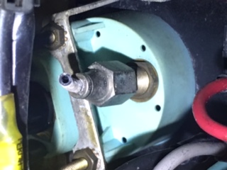

Hello all. I think I found the problem. See picture attached. Any thoughts on what type of tubing it is and how to replace it? I found the other end of this and it's very brittle and just breaks off in pieces when you touch it. Looks like a major challenge to run it from the engine to the gauge on the console. Thanks.--Todd

Based on the image provided, it appears the hose attached to the gauge with some sort of threaded fitting. The fitting appears to attach to the hose with some sort of compression fitting. To replace the old, missing, cracked, brittle hose, just get new, flexible hose of the same diameter and material. The hose is most likely either rubber or some sort of vinyl-plastic. The fitting on the engine end may be in better shape and give more clues to the nature of the hose.
