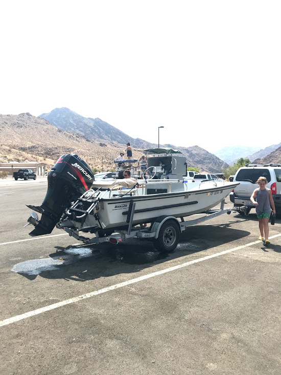

I hate to sound like a broken record, but yet again, de-winterized (such as the winters are in the South West), and she fired right up. Had a nice day motoring around the lake, stop, start, run smooth, repeat. Again, this carbureted Mercury 90hp FourStroke might as well be the fuel injected version as far as my usage is concerned. Other than being heavier* than a two-stroke-cycle 150hp motor, I love this motor. I also like that it's a Yamaha. I shop for powerhead parts as a Yamaha F100, and they are cheaper because they don't get the extra markup that Mercury takes, over and above the Yamaha prices.
My "winterizing" routine: take out the carburetor drain screws and let the carburetors drain
My "summerizing" routing: install the carburetor drain screws
*It's also dimensionally big. I was at the gas station last summer with it and some thirty-something woman asked me how fast it was and if it was a race boat. When I told her it only goes about 35mph, she couldn't believe it. She thought that with that "big" motor, it was some kind of hot rod. :-)
-Peter
