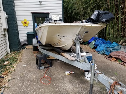

My 1970 Nauset has had a slow leak--about a pint or a quart--from the transom drain hole when I pull it out after a day's fishing. Some time ago, a storm surge lifted the bow unto the pier and bashed about a hundred chips from the bow gel coat. The apparent leak thru the gel coat has become a concern for rotting out wood structure,and I'd like to fix it. Picture of chips out of bow below.
The underlying fiberglass still seems sound to me--or at least no different from the rest of the hull--per tapping on the chipped sections.
What is the best approach [to repair damage to gel coat]?
Fill each individual hole or sections with lots of chips be ground out and then replaced?

Thanks Paul, the under lying fiberglass seems to be undamaged but my main motivation is to stop a leak so apparently there is some damage or possibly tiny cracks letting in a slow leak. Or some other leak.
I forgot to mention that it is a fresh water boat and always on a trailer meaning that the leak only happens when the boat is out on the water, which is probably only 3 or 4 times a year. Still I've had the boat or almost 40 years and would like to prevent any rotting from water inside the hull layers.
It seems to me there are too many small holes in the gelcoat each being about an eight of an inch, to attempt to bevel them with a Dremel tool. So I'm leaning towards using a grinder on the chipped areas and removing the gel coat between the chips in several patches each about 4 by 5 inches. As you suggest if the under layer is damaged it will have to be braced with matt otherwise I'm likely to just coat the patches with polyester resin and then gelcoat the patched areas.
Right now I'm removing the dark brown bottom paint with oven cleaner to expose the bottom gelcoat to attempt to find out if there is or are some other source of the leak.

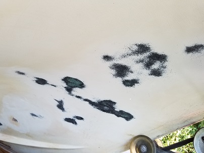

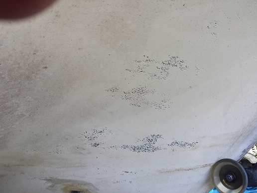

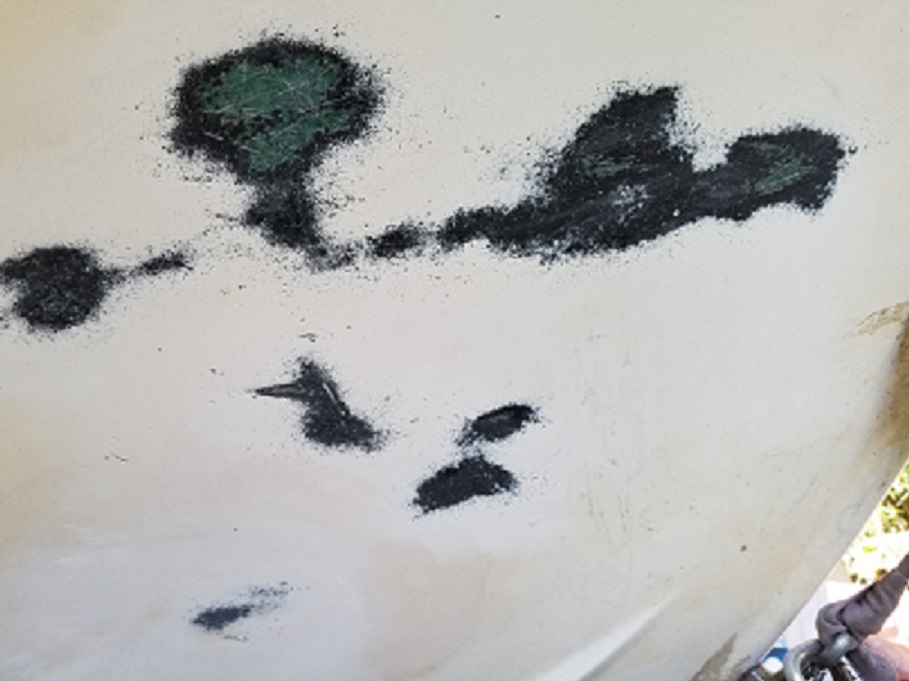

The work on the gelcoat this Labor Day weekend was to first power sand with a six inch disc sander at 50 grit and then finer sanding with a random orbital sander at 220 grit. Here's some pictures:
While waiting for the gelcoat to arrive I guess my next step would be to do some wet sanding with a sequence of successively higher grits. Hopefully the gelcoat over the spots will stop the slow leak. Any advice on the project would be appreciated!

I don't think that the damage to the bow, as shown and as described, could be producing a large volume of water ingress into the hull, and that any water that did enter at the bow would not be able to move rapidly to the transom where it can been seen leaking from a poorly sealed through-hull drain.
I think the water that comes out of a poorly sealed through-hull drain probably got into the hull in that area in that same manner, that is, it came in because of the poor seal at the through-hull drain. It did not migrate 15-feet from the bow, through the whole hull structure, to come out at the stern.
The damage at the bow tends to show the laminate under the gel coat is intact and still seated against and sealed to the foam. Yes, exposed laminate may take up some water, but I have my doubts that the water would be able to freely flow through all the laminate or foam and travel to the stern.
After the repair is made, if water still leaks from the drain at the stern after the boat has sat in the water for a while will be an interesting outcome.

Jim knows best and I agree with him.. Your pictures show very minimal damage that would leak, through foam, etc. Plugs are probably loose. Seal fabric that is exposed with epoxy. The boats I have repaired have significant visible cracks/damage1

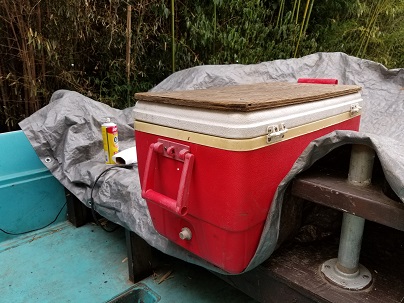

You all were right the chips in the gelcoat were not the source of the leak. The culprit was my old beer cooler!
I'd even gone to the extent of filling the boat with five inches of water with no leaks. Then it just occurred to me that one of coolers was leaking and sure enough it was that 20 year old cooler (picture below) that holds the beer. That is sure embarrassing but still it is a relief not to worry about water getting into the hull!
- The old beer cooler!
- Leaky Cooler.jpg (74.66 KiB) Viewed 9975 times

Very funny and a great outcome. That beer sure can cause some unintended consequences. Party on.
