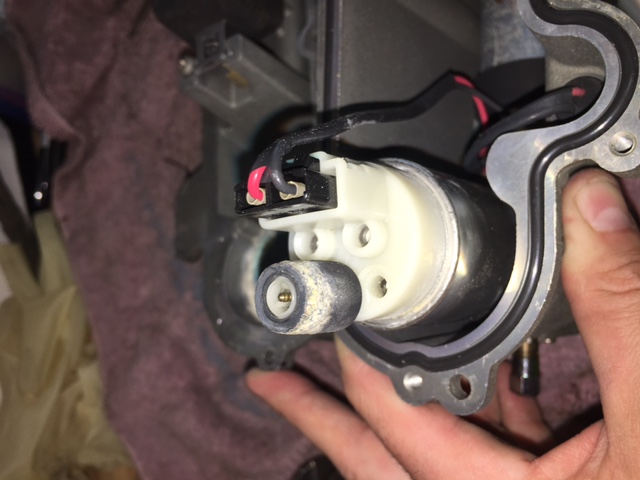

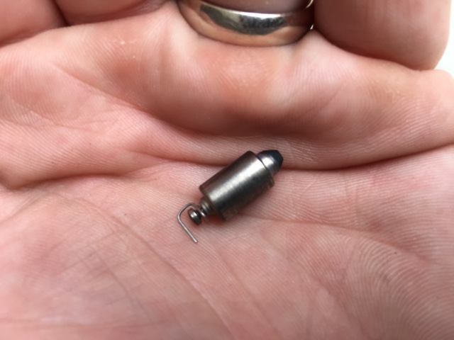

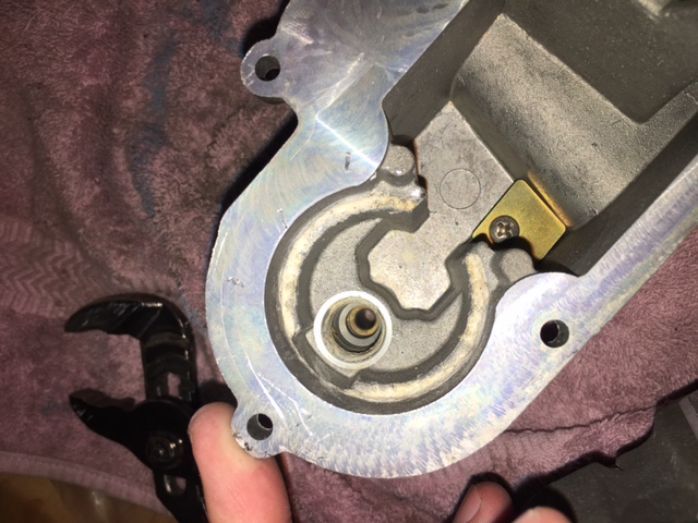

Update: 9/14/17
I have disassembled the entire Vapor Separator and did NOT find any significant debris or aluminum shavings. Basically nothing that is obviously the concern. Other than some minor corrosion and the Valve Kit Inlet seeming to have some carbonization on the tip, I can't pinpoint the concern. Pumps have been tested and running fine, so your presumption is correct jimh.
Is my best bet to replace the Valve Inlet Kit and pray that's the solution? Should I replace the entire Float Assembly Kit even though all the other parts are in good shape?
I also plan is to replace the vapor separator cover due to the damaged threads and also replace just the Valve inlet kit along with some of the rubber parts (gaskets/seals/o-rings/sleeve).
Am I doing the right thing here?
I don't have a factory service manual, I have been mostly following reliable youtube videos.
Any additional insight would be helpful. Thanks!

UPDATE 10/23/17:
Repair worked. I still can be sure the exact culprit but I'm pretty positive it was the Valve Kit Inlet.
Glad to be back up and running.
