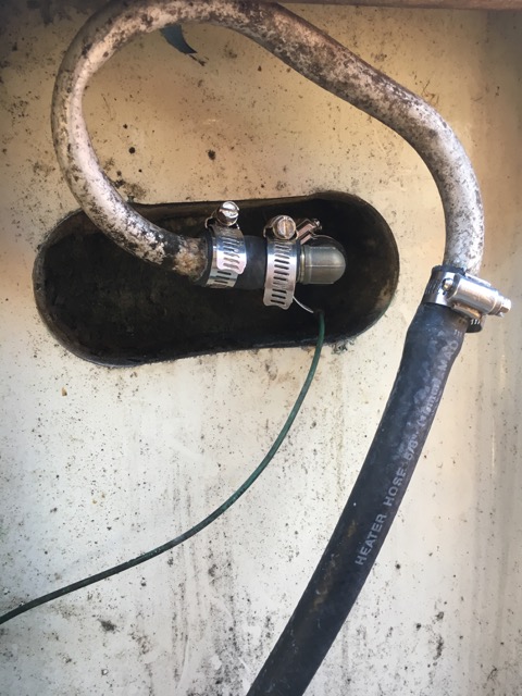

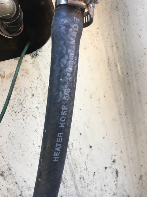

I've checked the vent line and it seems clear. Now I know the usual suspicion is the tank and hoses, but both were professionally replaced: the tank in 2007 and hoses in 2016. Looking at the hoses behind the starboard cover and they seem great (Marine Fuel Hose on the Filler and Goodyear rubber on the vent line). I can hear, via the starboard outside vent cap, the fuel entering the tank slowly.

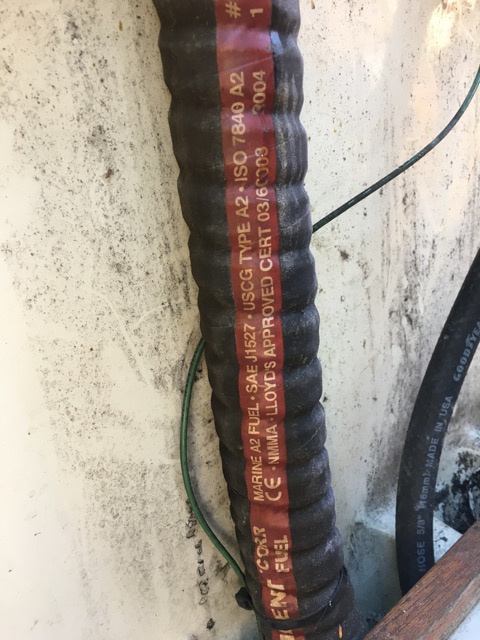

What are the date marks on all fuel hoses?
Do the hoses clearly state they are alcohol resistant?
Do the hoses clearly state their USCG rating designation as A1, A2, B1, or B2?

Marine A2 - compatible with Alcohol blended fuels. I didn't see the date but I believe it is less than 2 years old and looks in good shape. Even the bend doesn't look kinked.

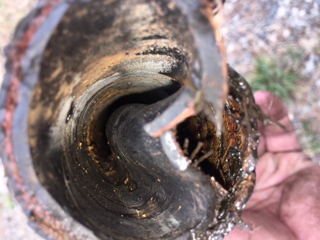

Ok, so the [cause of the slow fueling] has been found,?and it is indeed a collapsed fuel filler hose. Seems the A2 is the correct hose and I can’t find A1 in 1.5-inch size. I did get A1 to replace the vent line and will install that with the new filler line.

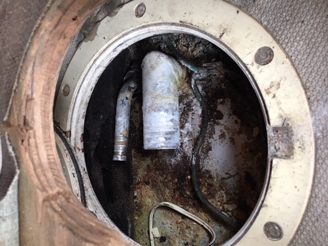

Getting the old hose off was a pain but eventually got it done. The tubes from the tank have a light corrosion powder on them, and I’m assuming I need to clean them before putting the new hose on. Hence my questions:
—how should I clean the tank pipes?
—what is the best method to get the new hoses on?
—can I use some grease?
What everI use I want to make sure it doesn’t leave the pipe slick to the point the hoses can come off.
—where does the grounding wire attach?
I’m assuming to a screw on the filler cap on the gunwale.

When I replaced those two hoses on my Revenge I used a little bit of grease on the tank intake and the 90 degree fitting. Made [fitting the hose to the tank pipe] easier.
A little bit of light sanding will clean up that corrosion.
My boat had a green [bonding] wire attached to one of the nuts and machine screws that hold on the fuel filler inlet.

Well, I was able to get both hoses under the floor and to the access area. Both the vent and fuel hoses slid on to the aluminium tank easily with nothing needed to lubricate. This worries me a bit but the new hoses are the same ID as the previous hoses. Double clamped both so i’ll Check for leaks when I fill for the first time.

Argh! The hardest part was getting all three screws on the fuel fill fitting on the gunwale as the the hose made it near 8mpossible to get the nuts on.. after much effort, i was off to get fuel. This time, nothing backed up, admirable! Once the tank was full I checked for leaks and my concern was unfortunately validated. Leaking at the tank inlet. I have two hose clamps on, the same ones as before, the same hose size and brand too and cranked the clamps very tight. I scoped the hose when I got home and you can see a slight gap between the tank barbed fitting and the hose.
I can’t tell if that is because the clamp isn’t close to the end of the tank fitting or something else is different.
I’m wondering if there is a sealant I can use? Or maybe I should try T-clamps?
