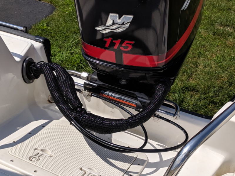

You should consider adding split loom or slit bilge hose to cover the rigging and protect it from the sun. Gives a finished look.

Phil, it took me a couple of years but after I replaced the fuel lines this year I added the split loom covering. Looks good! I was going to move the primer bulb under the rear seat, but then I decided that having the bulb and extra fuel line connections in the bilge seemed like A Bad Idea. -Bob
Fig. 20. Update showing new arrangement with mesh wiring loom or cover.
Re: 160 DAUNTLESS Hydraulic Steering Upgrade
Postby jimh » Sat Jul 06, 2019 8:51 pm
BOB--on many OEM installations I notice the fuel hose primer bulb is located close to the engine. Retaining it there on your rigging was a good decision.
