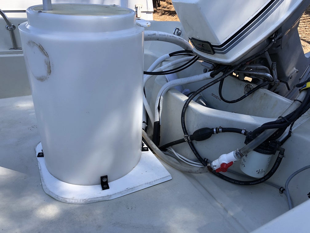

Hey Karlow - pics of my bait tank set up on my 17 foot whaler. As I said, I mounted the tank to a piece of 1 inch starboard. The starboard is then mechanically attached to the sump cover over the bilge. The sump cover has always been screwed down into the hull, so that is what holds this all in place. I did not add any new holes into the hull.
I've had this set up for a few years. My observations -if I stay in shore and fish the local kelp, the bait typically lasts all day. If I go offshore for a longer run, and if there is any chop the bait does not fair as well. It tends to get bumped around. I just take half a scoop, the tank is too small and can not hold more.
I am also still trying to dial in intake flow. I have it a valve to gate the water in flow, but still trying to get that dialed in.....
Ideally, I'd like to find an oval tank that is a little bigger, if anyone out there has experience with this size on a 17 whaler, please give me feedback on your thoughts.

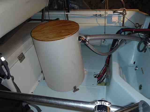

That was the original set up on my 17 ft boat. I have updated to a Kodiak tank with better results.
