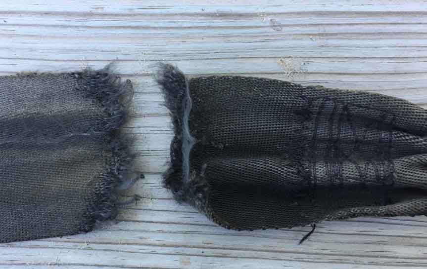

The trailer winch is, I presume, the one that came with the trailer when new in 1992. The winch was a Fulton two-speed winch, rated 2,600-lbs, and was model number 2625. This summer I noticed that the winch strap was showing some signs of wear and decay in the the last one-foot of the strap that connect to the metal hook. I made a note of that and thought about replacing the strap. That thought was lost, and the action of replacing the strap was not completed before I left on a major highway trailer trip.
About a month later, I was loading my REVENGE 22 W-T Whaler Drive boat onto the trailer in Little Current, Ontario, on Manitoulin Island in northern Lake Huron, at the very nice launching ramp at SPIDER BAY MARINA at the end of a delightful week of cruising up there. When loading my boat, the last one-foot of forward movement is always the most difficult because by that time almost all of the boat hull is out of the water, and there are minimal buoyant forces lifting the boat off the trailer bunks. (My trailer has keel rollers on the forward part of the trailer and bunks at the rear.) Pulling the last one-foot of forward travel often requires me to shift to the lower-gear of the winch, and give the winch about one turn of the crank. Loading that day was no different, except as I added tension to the winch strap to pull the boat the last few inches, the strap calmly and nicely ripped itself in two.
This 3-inch wide winch strap failed after about 25-years in service.
I managed to work around that failure by just tying the remnant of the strap onto the bow eye and augmenting the winch pull with some engine thrust. We got the boat on the trailer, and headed to home, 390-miles away. About two weeks later I got around to investigating the winch strap problem.
My initial thought was to just replace the strap. The drum on the OEM winch was sized for a 3-inch wide strap. I called several boat shops in the area to see if they had a 3-inch strap in stock, but none had one. I looked at buying one on-line, and found that a typical 3-inch wide strap was about $45.
A further problem was getting those two half-hitches I had tied in the old winch strap off the bow eye. That knot had really tightened under the tension of the winch strap. It took a few minutes to get it loose. I then spooled off the old strap from the winch drum. I discovered that the winch drum was rusted, and, most surprising, the attachment of the bitter end of the winch strap to the drum was rather haphazard. There should have been a special bolt and spacer to hold the loop sewn into the end of the strap, but instead the strap had been folded over and threaded through some holes in the drum which were really intended for wire rope cable. At this point I decided to just replace the whole winch.

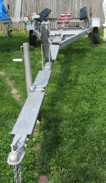

On my trailer there is nothing akin to that. The center support tube at the front of my trailer ends just a foot or two past the winch post. Creation of a wide platform to enable waking out and crouching onto for the purpose of attaching the trailer strap hook to the boat's bow eye would require reconstructing the forward part of the trailer, as can be seen below in Figure 3.
Fig. 3. The forward part of the boat trailer whose refurbishment is under discussion; the center tube that is the trailer tongue only extends about two feet past the winch post, and to access the bow stem of the boat during loading from this position would be impossible. Also, the keel roller at the bow would have to be stepped over, creating another hazard.
The entire purpose of buying and using the E Z Hooker boat hook is to reduce the risk of injury and avoid situations which increase that risk. On that basis, the Star Brite E Z Hooker boat hook has the required assets, and its modest investment has proven very worthwhile.
