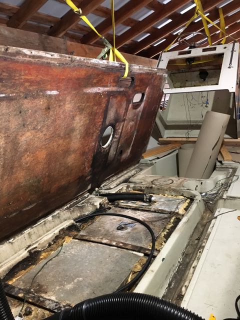

I was finally able to remove the rigging from the console and remove it from the deck. I slid it to the bow and removed the guts so I can sit in the forward well with easy access to rewire.

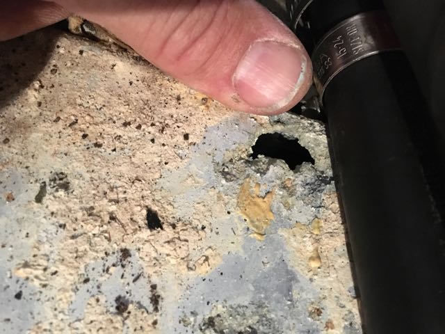

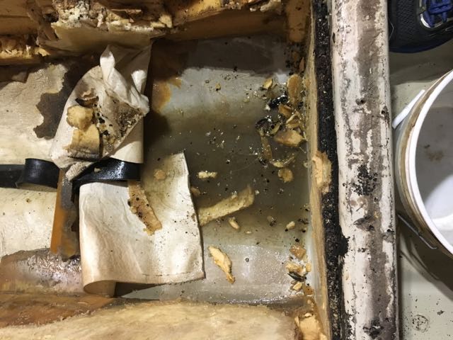

With the Deck lifted, I finally had easy access to the tank. The tank was replaced in 2007 with a brand new one from Florida Marine Tanks. I suspect the work was done poorly given the premature failure. In the photos below, you will see many surface corrosion holes and plenty sludge consisting of Fuel and Water (nearly 2 gallons + whatever is still in the foam).
I don't think the yard that replaced the tank pulled all the existing foam and replaced with new foam given the various types of foam I'm seeing and clearly different layers.

I did notice that there is a clear line of holes that ran under the fill hose. This was something I had to replace initially as the hose had collapse and would no longer easily allow the tank to fill. It's probably a factor only in that it was sitting on the tank and probably held moisture against the metal. I found pitting elsewhere and a smaller hole near the pickups. All of the damage was on the surface from what I can see.

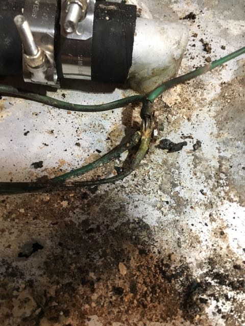

Here is a picture of the Bonding wire.. It ran from the Ground Bus Bar to the tank. From this point, individual wires ran to the Pickup and Fuel Filler (not the vent - not sure if that matters) and a wire running out to the stern. I need to check where that wire goes.
Is this the proper way to bond everything? There were two other tabs on the tank that were not bonded, nor was the Pickup - but I didn't see anywhere to bond with that.

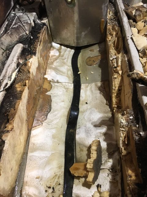

Here is the cavity with the fuel tank mostly out. I now need to figure out how to remove the remaining foam and clean everything. Any recommendations?
- TankCavity.jpg (63.5 KiB) Viewed 6331 times
Re: Fuel Tank Replacement / Re-rigging Project...
Start scraping that foam out with a spatula. When I did mine it all came out rather easily once tank was removed. After I got it all out I scrubbed and polished the cavity. Instead of using expanding foam I used those foam floor mats they put in children play areas.

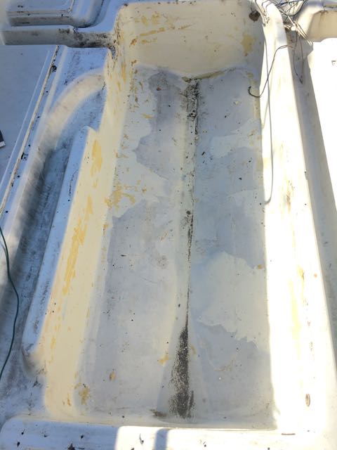

I've been able to get most of the foam out with the help of a pressure washer. I've been scraping with a paint scraper but still not getting the last bits off— any ideas? I'd rather not resort to sanding. And not sure if Acetone would help or just create other problems.
