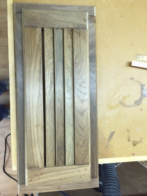

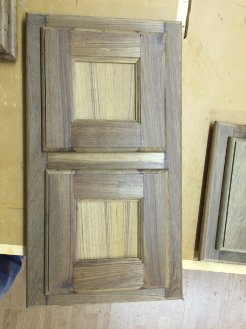

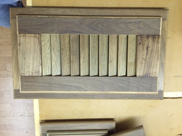

i decided to make new doors for my 1990 Super Console. $150 of FEQ Teak and a day in my shop. I still need to sand and finish. I am not sure if I will oil or Varnish.. One more step on my Outrage 25 rehab. You have to love Classic Whalers...

Wow, very nice work! Nice wood grain selection, too.
If in the sun a lot, I might would choose oil vs varnish, but varnish is prettier I think.
Thanks fit sharing...be sure and post again once finished and mounted. Love those 25s. Thanx, mav
