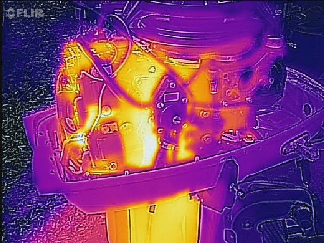

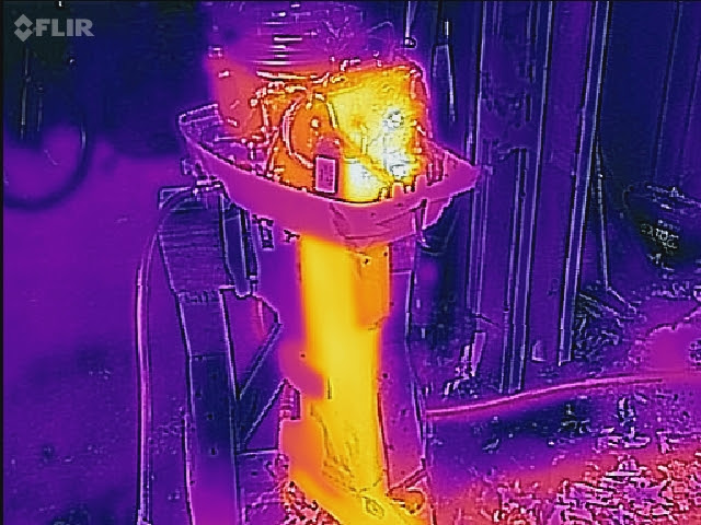

Just wanted to post a couple of pics taken after I finished the rebuild of the Johnson 30-HP engine from my 1980 Sport 13.
[The images seen below and water marked with the FLIR logo in the upper left corner were taken with what was later identified to be a FLIR Systems model FLIR ONE thermal camera that] plugs into my Android phone. [The FLIR ONE] was only $250, as compared to thousands for a real [FLIR Systems-brand] camera. You can clearly see the heat signatures while running, and I see [the FLIR ONE thermal imaging camera] as a good tool for diagnosing cooling or ignition problems.
I have also tried [using the FLIR ONE] to check the hull with mixed results. In theory a wet area will show up as a cooler thermal area.
The [FLIR System FLIR ONE] is an attachment which plugs into a port on either an Android or Apple phone. [A specialized appplication] on [certain Android and iPhone smartphones] captures the image. [The FLIR ONE] is not a stand alone device. Essentially it turns your smartphone into a [thermal] camera. [The FLIR ONE] is manufactured by FLIR Systems, [and there is a FLIR water mark on all] the images.
I initially purchased [the FLIR ONE] to help spot drafts in my house so that I could target where to improve insulation, and I found other uses.

Thanks for posting those interesting heat-sensor images. I notice the fuel pump is much cooler than the surrounding engine components, probably due to the cooling effect of the fuel passing through it.

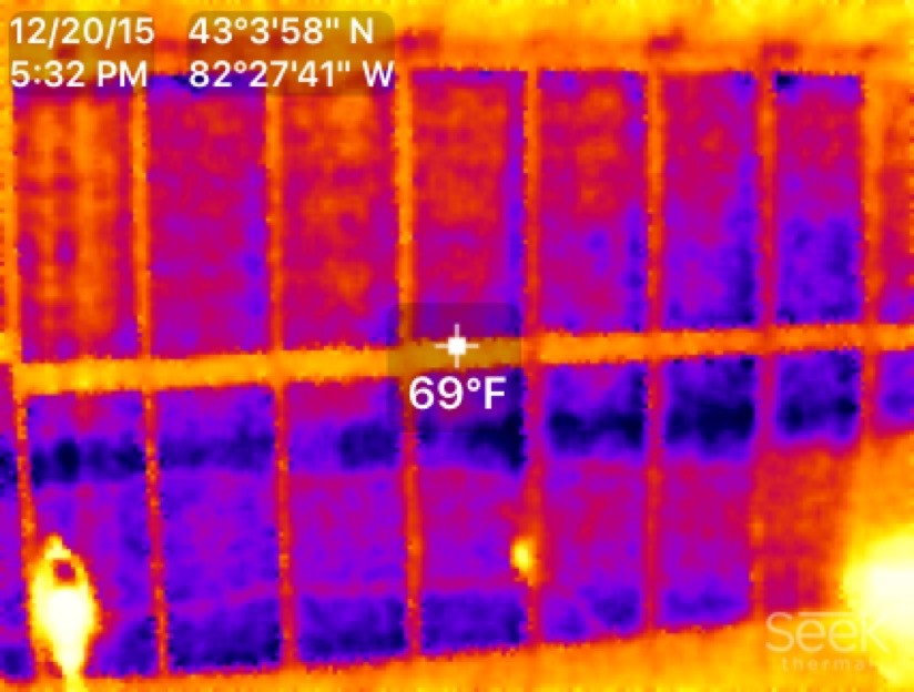

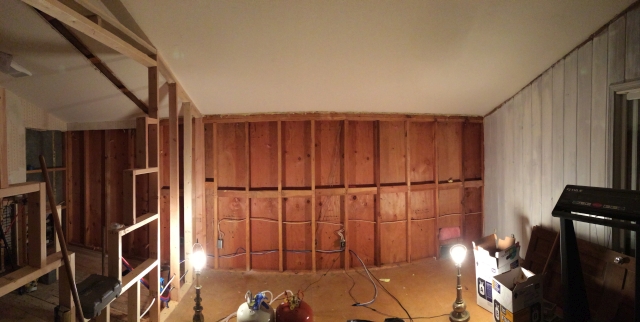

We've been remodeling my folks cottage on Lake Huron. One of the problems has been cold drafts on the north side of the structure, ever since it was built in the early 70's (prior to the now pretty standard procedure of wrapping homes). We decided to remove the knotty pine paneling, on the north wall of the master bedroom, remove the 40+ year old standard batt insulation, replacing it with closed cell spray foam. Below are some images showing bare wall, both clear:
bare normal.JPG (149.61 KiB) Viewed 15957 times
and thermal. You can observe the line where the first floor roof meets the vertical wall very easily:
bare thermal.JPG (115.36 KiB) Viewed 15957 times

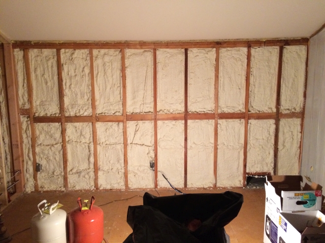

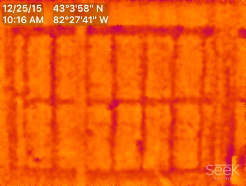

And below are the images after spraying the cavity with closed cell foam:
sprayed normal.JPG (221.75 KiB) Viewed 15957 times
and
sprayed thermal.JPG (95.78 KiB) Viewed 15957 times
For those interested in the L/L read accuracy, here's a G/Earth shot. About 40' off:
