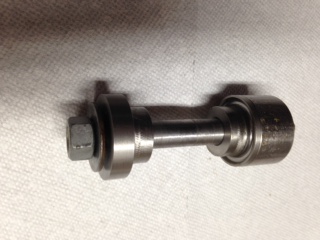

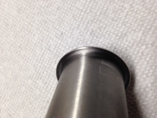

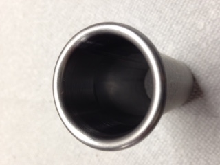

I'm always looking for something to make on my old South Bend lathe, so I decided to make my own flaring tool (Fig. 2.) As you can see in Fig.3 and Fig. 4, the resulting flares were much better than I expected. I don't know if the commercially available flaring tools would work as well on stainless.
Fig. 2. Flaring tool made on lathe.
Fig. 3. Flared stainless steel tube
Fig. 4. Flared stainless steel tube, reverse view
I was encouraged, and I ordered some 1" OD x .035 wall 316 stainless tubing (McMaster part #89785K867) for the two smaller thru hull drains along with the needed O-rings (McMaster Part #9557K486 and #9557K482).
The tubing has a soft temper, and I'm hoping it will form as well as the old oven handles. Even though the old brass tube on the center splash well drain came out in two pieces, the wood showed no rot and was only slightly damp. I positioned a fan to blow thru the hole for a day and then sealed the wood with some low viscosity epoxy.
I haven't installed that tube yet and thus haven't formed the opposing flare. As soon as I do, I will post more images.

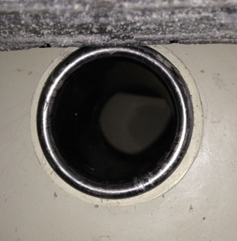

More information on the installation of stainless steel through hull drain tubes.
The opposing flair formed very well. I was afraid that I would over-form the existing flair in forming the opposing one. To help prevent this, I used some high pressure grease on the opposing flair and some #100 carborundum grit on the existing one to lock it in place on the forming die. This might not have been necessary as the pressure from the O-ring may have prevented it from overforming. I also used some Loctite PL Marine Fast Cure Adhesive Sealant on the O-rings. I think this is similar to 3M 4200.
I haven't replaced the remaining through hull tubes yet --I am having too much fun fishing--so I can't say how well the McMaster 316 stainless alloy tubing will work.
Fig. 5. Inboard view of drain
Fig. 6. Outboard of drain
