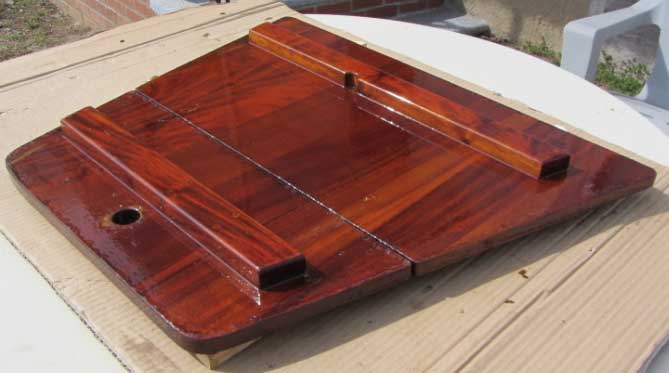

For the wood I bought a blemished cover for the seventeen foot Montauk at a steep discount from Specialty Marine. I knew I was going to cut it for a folding hatch so cutting the larger cover down to the fifteen foot size was not a concern.
There are two lateral braces on the underside. The rear brace fits right up against the bulkhead so that will keep the cover from sliding off.
There is a finger hole at the rear edge for lifting the cover but I wanted that on the front hinged section. I used a hole saw to cut a new finger hole up front. then I used that plug to fill the old hole.
There is a coat of varnish on the cover but it was not very good. I guess that is the "blemish." I have no problem sanding it all off for a new coating system.

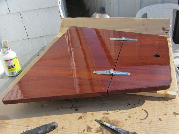

The hinges I am using I have had for forty years. They are Perko chrome plated bronze strap hinges. This is a case where it really paid to buy quality.

I understand it's a fishing boat and looking like fine furniture isn't important. If you go with a plywood, just make sure it's marine grade so the glue is waterproof and won't delam in moisture.
I got away from plywood and laminate the pieces together and put a reinforcement piece underneath to prevent from warping and you could to the same with 3/4' ply. Personally, I'd use Epoxy to laminate together and also for the reinforcement with a "glue and screw" approach which will make it last a long time. Since appearance isn't important, I'd also cover in epoxy and then paint with a polyurethane paint, but if going with the OEM look, varnish would be the option. Paint lasts longer in the sun than varnish.
I've made a few others for friend's the same way and they hold up nice.

Your cover looks exactly like the one I got from Specialty Marine with the exception of the white lines.
I cut mine for a hinged access to drop fish in. I cut it so there was a brace left on each section.

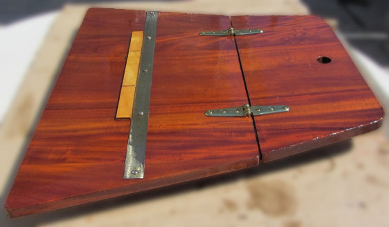

[The illustration below shows] where [the project to create a replacement hatch for the SPORT 15 has progressed] so far.
Fig. 1. New reproduction hatch for SPORT 15.
The braces underside keep the hatch located nicely. It can't slide out in rough seas. I had to fill in the original hole with the plug I cut for the new hole.

What method was used to join the two pieces of wood that form the hatch?
Oldslowandugly
Posts: 719
Location: Queens NY
Re: Sport 15 Making Replacement Anchor Locker Hatch Cover
Postby Oldslowandugly » Thu Mar 19, 2020 10:03 am
The two pieces of the hatch are not joined.
The hatch was made by Specialty Marine as a single piece to fit the Montauk 17. I cut it down to fit the Sport 15 well. Then I cut it to make a folding hatch.
There are two Perko hinges on the other side. The larger piece stays in place while I lift the front to put fish in. That is why I made a new finger hole and filled the original hole.
The varnish was still tacky so I took a picture of the bottom first. When this rain passes, I can put more coats on the top side. Then I will take a picture of that and you will see the hinges.
When I purchased the hatch it was a closeout sale as a "blemished" item. That worked for me as I knew I would be cutting it anyway to make a folding hatch. I just checked the site and they must have all sold out.

The Sun came out! Here is the top side with the hinges. You can just see the old hole that I plugged. That used to be the center so you can see how much I cut it down by. The 17-footer hatch is about five inches wider than the 15-footer hatch. Length was almost the same.
New hatch top side

The almost finished hatch.
The stainless steel ruler [seen above screwed onto the hatch ] was cleaned up and varnished.
The little wood blocks are oak parquet flooring. The [opening front] hatch rests on them in the open position.

Postby jimh » Sat Mar 28, 2020 2:04 pm
Two rubber feet would have made a much less aesthetically compromised way to cushion the opening portion of the hatch when it lands on the aft part of the hatch. Or a small fiddle on the very front of the opening part.
The new hatch looked a lot better before the ruler and the wood blocks went on.
The outer screw fastener holding the ruler [nearest one in your illustration above] looks like a flat-head or oval-head screw. The middle three of the five screw fasteners look like they are binder-head screws.
Q: Why different heads on the screws?
Q: Why five screw fasteners on the ruler?

jimh wrote:The new hatch looked a lot better before the ruler and the wood blocks went on.
Of course it did. Much like a spanking new hull looks better than after it is fitted out. The oak was handy, and I had no mahogany pieces like that.
I have used rubber feet before. They did not last. I also considered spreading the load out since my considerable bulk will probably end up standing on the open hatch during a Bluefish blitz.
Same with the ruler. I don't want any chance of dislodging it. I can assure you all the screws are the same stainless flat heads. Even though the front swivel seat places the feet in front of the ruler and wood I plan for the worst. I am rarely disappointed.
