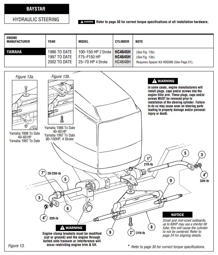

See from the instructions below where it says: "Engine clamp brackets must be modified...." This may be necessary for Yamaha.

You do not have a "clamp-on" bracket. Your engine is has a bolt on bracket.
No modification necessary.

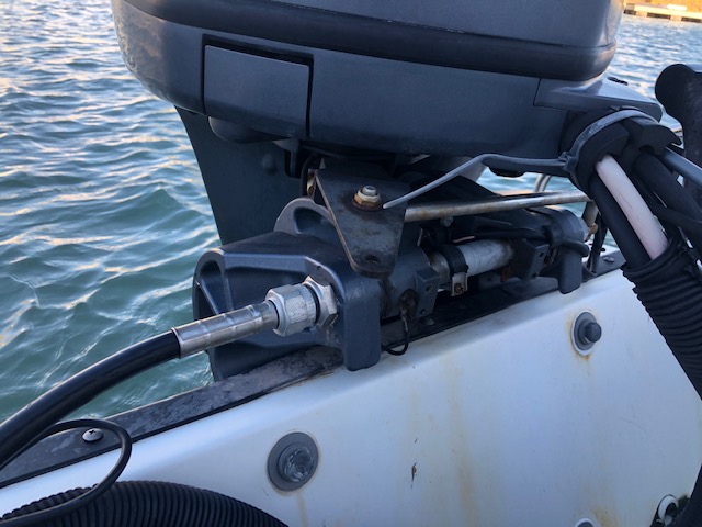

I see the callout in the instructions that talks about cutting or grinding the bracket, and I see in your original photo the small "tab" that sticks down from where the steering cable enters the engine bracket. But I don't see how leaving it there would be an interference problem. In particular, the photo below from my installation does not look like there's any part of the Baystar system that hangs below the bracket.
And if worst comes to worst, then just cut the tabs off with a Dremel.

Supposedly the [interference between the Yamaha F90 engine mount and the DOMETIC Baystar hydraulic steering occurs] when you tilt the engine all the way up: the hydraulic [actuator--Callout 8 in the diagram above] will hit the engine mounting tabs--not a huge deal. I was just trying to get a clearer idea of what I would need to tackle [to install Baystar hydraulic steering on the Yamaha F90 engine].

Grinding off those [mounting ear extensions] is no big deal. Their removal does not present any structural problems. I am not sure why they even have them--nobody mounts an engine all the way down. And it is unlikely they would hold the engine on if somebody did mount an engine that low.
