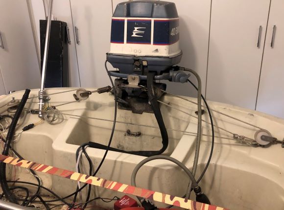

I am at a point on my 1978 13 Sport where I need to remove the engine, move it to a stand, and then remove the remaining interior parts.
First I need advice on the removal of the wire rope and pulley steering system and the tension spring at the engine. Is there a process and an easy way to do this, first to release the tension and then to start to take off the steering?

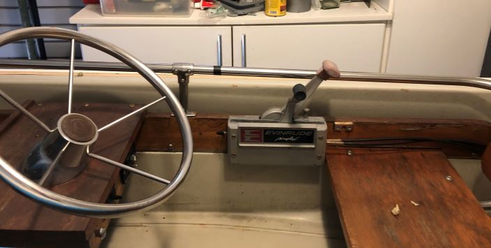

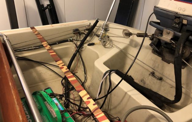

Advice would be appreciated, or if there is a write up in the manual or other place. Separately, I am planning to just take photos and notes as I remove the parts. Let me know if there is a trick or advice to removing the interior parts of a 13-footerfor a first timer. I'm concerned about making sure everything goes back in correctly and getting boat back together to its current form. Photos attached of current interior.

I do not have any first-hand actual experience with disassembly of the wire rope and pulley steering system, but if I were trying to remove it from the boat, I would proceed as follows:
  • preserve the wraps of the wire rope around the drum of the steering wheel so that they do not become loose; use gaffer's tape to hold the wraps on the drum;
  • disconnect the steering link to the engine; this should reduce the tension in the system by allowing the spring to contract;
  • leave the steering cables intact; in this way when reassembling them they will not have to be adjusted; if complete removal of the system is necessary, remove the pad eyes that hold the pulleys in place; noting any peculiarities about their location in the system to make reassembly simple

I would anticipate that the portion of the wire rope that has been spooled onto the drum at the steering wheel for many decades may have taken a set and be resistant to laying in a different orientation during reassembly. That is why I suggested to preserve those wraps of wire rope on the steering wheel drum.
If you think the removal and reinstallation of the steering system will be too difficult, perhaps you could leave it in place and work around it in your refurbishment. From what I can see of the boat hull in the three illustrations above, the boat appears to be in rather good condition. I would not anticipate that you will need to completely repaint the hull and cockpit.

If refinishing the wood, the majority of cable needs to be removed as you can see where the cable exits the console and goes through pulleys in the side wood. In order to remove the console you will need to remove the cable from the helm and then later respool it. You may however be able to disconnect everything and remove the console, side piece, and the entire steering in one piece. If possible, that would be my attack plan.
With the right amount of pictures and notes it should go back together much easier.

I had removed the cable and pulleys from a similar vintage SPORT 13 for a few years when I was using a 9.9-HP two-strokeppower-cycle tiller-steering engine on a local lake. Eventually they allowed motors up to 20-HP to be used, and I reinstalled the pulleys and bought new cable and clamps. Since I never removed the helm it was not too hard to reinstall the parts, maybe a few hours. Take pictures before removing anything and you should be okay--if your reasonably handy.
