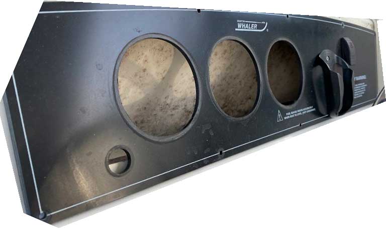

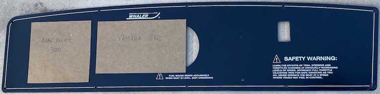

What type of plastic [was used to make the instrument panel for a 2001 CONQUEST 23]? The finish in a matte black.
Fig. 1. An instrument panel made by Boston Whaler for a 2001 CONQEST 23.
TWO BACKSTORIES:
ACTIVITY ON FORUM: I was a long time member from the old [forum] here. It's been a while since I have participated because of kids and life in general. I never stopped boating. I'm slowly getting back into boating, now that my kids are old enough to be somewhat independent.
NEED FOR PANEL: I am in the process of re-powering my 2001 23 Conquest that came factory rigged with twin Mercury engines. I will re-power with twin Yamaha F150 engines, and that means all-new rigging and new digital gauges. The existing instrumentation panel has more holes than I need to fit the new gauges.
I have contacted Whaler seeking a brand new panel without pre-cut holes, but they tell me that part is discontinued. I am disappointed I can't get an OEM panel with the Boston Whaler logo and striping.
I thought of fabricating something like this from a local plastic shop but they don't stock the exact type of plastic. The guy at the plastic shop speculated this is some kid of ABS plastic. The alternative is to use KING StarBoard, but I really want maintain the look of the original.

To deduce the type of plastic from the image is very difficult or impossible. Generally I have seen that Boston Whaler instrument panels often are made with a plastic material that has a black surface and a white underlying material, and the lines, logos, and legends are engraved into the panel, with the engraving resulting in white letters on a black background. I do not believe it will be possible for you to duplicate an engraved panel. To duplicate a non-engraved panel will be much easier.
However, this panel just looks like it was made from black plastic, and the lines and legends are applied to it, and making a similar replacement will be much simpler.
I don't think there is great concern about the exact material for the black plastic. Almost any black plastic sheet of appropriate thickness ought to be workable.
Rather than using plastic, I recommend you use a sheet of aluminum of 6061T6 alloy to fabricate a panel. Aluminum sheet about 0.125-inch thick ought to be sufficiently strong. Aluminum is easy to work, to cut, to shape, and to prepare for paint. Drilling large diameter holes for gauges in a plastic sheet can be difficult. Drilling in aluminum will be easier, in my experience.
I would drill all holes needed before painting. Test fit all gauges into the panel and test fit the panel before painting. Be especially precise in locating the several holes for the screw fasteners that wii remain the panel to the dashboard.
I suggest painting the panel with KRYLON matte black paint using a spray can. You can also use a primer coat for better adhesion before applying the black top coat or coats.

ivansfo wrote:The guy at the plastic shop speculated this is some kid of ABS plastic.
Acrylonitrile Butadiene Styrene (ABS) is a thermoplastic that becomes liquid a 221 degrees Fahrenheit. You would have to be careful cutting it so as not to induce melting. I would be surprised if that is the material being used. I would expect that ABS plastics are used for making plastic components using some sort of mold process.

Fig. 4. Another view of the OEM instrument panel with cardboard rectangles covering parts of the panel.

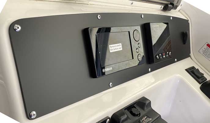

I am happy to report my new panel is done. I ordered the plastic sheet from Decorative Plastics (as mentioned earlier in the thread by kwik_wurk).
https://shop.decorativeplasticsheets.com/main.sc
A sheet cost about $80, and the sheet is large enough to make four or five panels in the size I need--enough material for screw-ups.
Fortunately, I took my time and the first attempt came out nicey enough. The labor was quite intensive with basic shop tools, and now I can understand the charges by plastic fabrication shops.

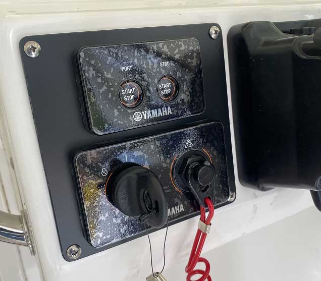

Also I used the same plastic panel to mount new Yamaha switches in the old cutouts left by the Mercury key switches.
Thank you all for the tips, leads, and advice.
Fig. 5. New dash panel.
Fig. 6. Holes from from old engine controls.
Fig. 7. New key switch panel covering old holes.

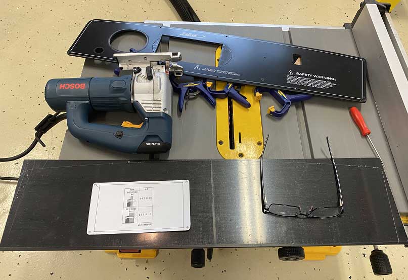

Can you detail the tools and techniques you used to produce the panels?
ivansfo
Posts: 26
Joined: Fri Nov 13, 2020 7:21 pm
Re: OEM Instrument Panel Plastic
Postby ivansfo » Mon Feb 22, 2021 3:52 pm
Phil T wrote:Can you detail the tools and techniques you used to produce the panels?

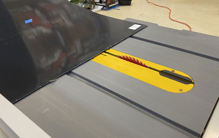

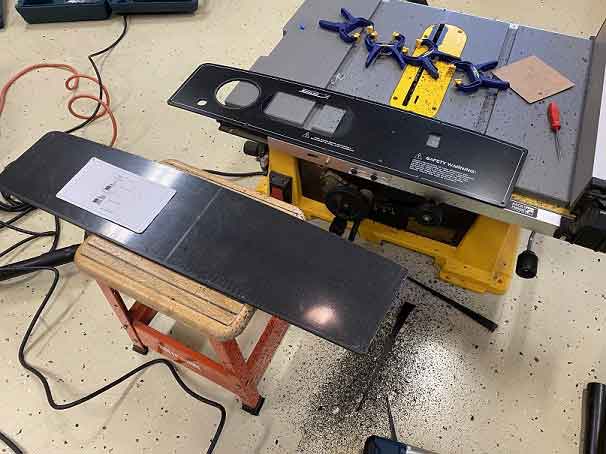

  1. Traced out the new panel using the original panel as a template.
  2. Cut out a new panel using a table saw for the straight edges. For non-straight edges, used a jig saw. Equipping the saws with fine tooth blades seemed to help quite a bit.
  3. Again I used the original panel as a jig to drill out the matching screw holes.
  4. Used a palm router to chamfer the perimeter edge. Tiny detail but I wanted to match the original as much as I could.
  5. Used a jig saw and files to cut out the openings for the new gauges.
There was a lot of filing and sanding in between these steps. The most challenging part is not to make a mistake that was bad enough to warrant starting all over. So measuring twice or even three times before cutting is essential. There are imperfections in this first attempt but I'm going to leave it as-is for now. I currently don't have the patience to try making another. And as you can see in the following pictures, the job is messy.
Fig. 8. Large sheet on a table saw.
Fig. 9. Old panel used as template for new.
Fig. 10. Some tools and the workshop floor.
Fig. 11. New and old panels stacked together.

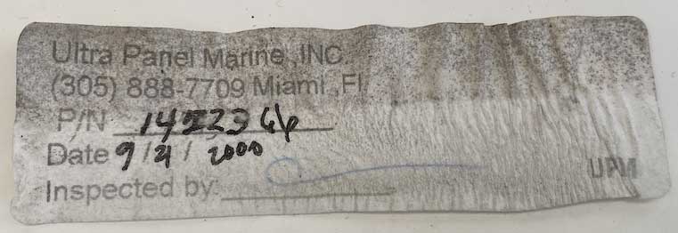

ASIDE ON A DIFFERENT PANEL: as I was working on the circuit breaker panel over the weekend, adried up label dropped from the circuit breaker panel. The original vendor for the circuit breaker panel was identified as Ultra Panel Marine in Miami, Florida. If anyone needs a circuit breaker panel from [a 2001 CONQUEST 23], it may be worth the time to contact them.
Fig. 12. Manufacturer name tag.
[Moderator’s note: the OEM circuit breaker panel is NOT the panel being replaced that appears in the several illustrations in the thread.]

What is the part number for the OEM circuit breaker panel? It is a bit hard to read the number from Figure 12.

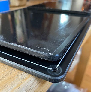

The thickness of the plastic sheet for the panels as seen in Figure 11 surprises me. What is that dimension?
Your cut for the curved upper edge of the panel looks good. Nice work with a jig saw. I suspect there was some sanding. I like the edge bevel on the panel.

jimh wrote:The thickness of the plastic sheet for the panels as seen in Figure 11 surprises me. What is that dimension?
Thanks Jim. The plastic sheet I purchased is 3/16" thickness. This is what Decorative Plastics recommended for boat instrument panels. The thickness is an exact match to the original Whaler panel.
After cutting with a jig saw, there was indeed a lot of sanding. I could have wet sanded to even a smoother finish but it's good enough.
