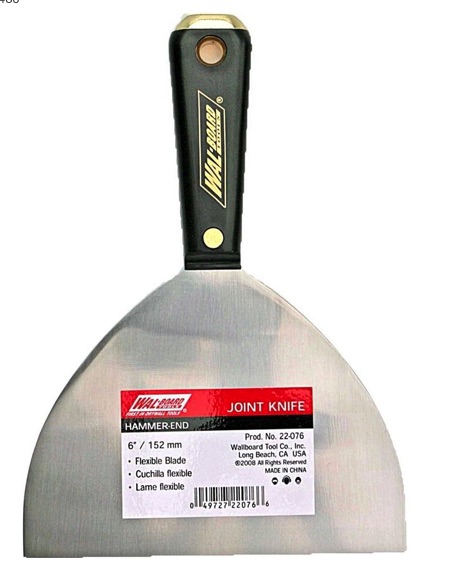

I would try a drywall compound knife. It has a handle, sharp corners to dig into the adhesive and is stiff so you can hit it with a hammer.
