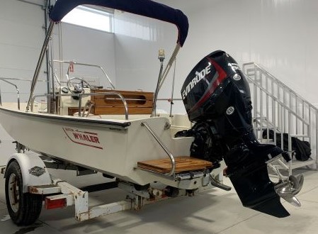

[For a] 1985 Montauk 17 with [an E-TEC] 90 that is now on an oversized single-axle Shorland'r all-roller trailer and will be trailered quite a bit, what is the urgency to change to a bunk trailer?
I have read the trailer reference guide so I know [a trailer with floppy-rollers is] not preferred. The previous owner has experienced no problems.
Fig. 1. MONTAUK 17 seen from port stern quarter.

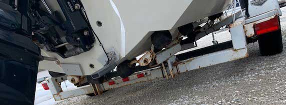

All three of my boats (Montauk 17, Outrage 17) have been on bunk trailers. I trailer 100% and visit many different ramps.
I added keel rollers to allow me to launch the boat easily on the varied ramps. I found a keel roller setup requires less depth in the water to launch or retrieve.
In reviewing the current trailer in the photo, it should be modified by simply adding two 12" non-marring keel rollers (one on each side) to the rear crossmember, a single 10" non-marring keel roller on the crossmember forward of the axle.
The existing short adjustable bunks should be replaced with 5' bunks with brackets installed on both cross members.
The boat sits on the keel rollers and the bunks provide lateral stability. When setup correctly one can push the boat off and winch it forward when out of the water.
Fig. 3. Trailer with both bunks and keel rollers.

PHIL--that trailer you illustrate in Figure 3 looks great. Mounting the keel rollers in pairs on each side of a trailer cross member is the best method for installation. That trailer just needs white PVC poles at the aft end as guides for the boat during loading and launching.

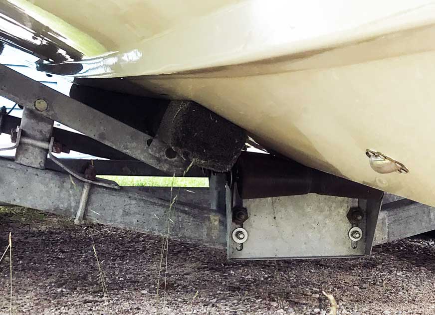

Here is a view of my trailer with the boat loaded. It shows that the support is from both bunks and keel rollers.
Fig. 4. Boston Whaler OUTRAGE-style V-hull supported on trailer by both keel rollers and bunks.
The lighting for the above image was not the best and obscures some details. The keel rollers are 12-inch yellow polyurethane Stoltz rollers. The roller brackets are 12-inch galvanized steel. Note how the lower bolts in the bracket mount are passing through the trailer frame member. This was necessary to get sufficient height of the roller above the trailer frame. The holes in the trailer frame were drilled in the exact center of the vertical height of the frame member; this minimizes loss of strength. The brackets are mounted in pairs, so they more or less clamp the trailer member between them; this restores some strength to the trailer member.
The boat is carried on the trailer as low as possible, that is, as close to the fenders as possible. The chine line of the hull clears the fenders of the trailer by about 1-inch. The lower the boat on the trailer, the less immersion of the trailer into the water will be needed to launch or load.
This trailer is an E-Z-LOADER and has the somewhat unique twin-bunks that pivot; this helps to equalize the weight loading between the two bunks. The bunk seen above is as close to the keel centerline as possible without hitting the keel roller brackets. Weight-bearing bunks should be close to the keel center line.
The (unseen) second bunk paired with the inner bunk is farther outboard from the keel. It is position well inside the hull runner in order to not interfere with the overboard hull drain on starboard side; the drain is protected with a inverted Perko vent and could be damaged if the bunk were improperly positioned during loading--which can happen.

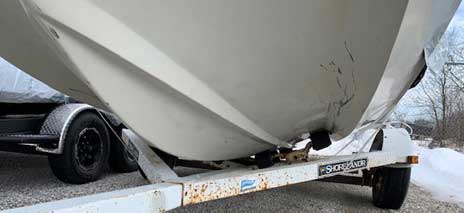

Fig. 5. View of MONTAUK 17 loaded on the trailer under discussion in this thread.
Fig. 6. Another view of MONTAUK 17 loaded on the trailer under discussion in this thread.

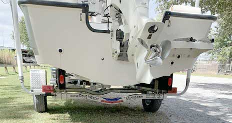

I would suggest setting up the trailer with the bunks as high as you can. This way you have no worries about the keel scrapping the trailer. ‘V’ axles and cross members are essential too. The trailer I bought for my 2003 190 Nantucket is shown in Figure 8 below.
Fig. 8. Stern view of trailer for 190 NANTUCKET.

If the trailer is properly set up with bunks, keel rollers (very important), and guide posts, the keel of the boat will never strike the trailer frame during loading or unloading. The boat hull leaves the trailer, the hull becomes buoyant and is raised off the trailer during launching. During loading, the only way for the boat to hit the trailer is if the trailer is improperly immersed in the water, that is, if the trailer is not sufficiently deep in the water.

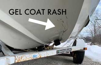

On the subject of the boat hull being damaged by striking the trailer frame, in Figure 5 above I see that the boat under discussion on the trailer under discussion has already apparently received a lot of damage to the hull from striking the trailer, probably from the keel roller spindles. That sort of "gel coat rash" is a problem that should be remedied with urgency.
Fig. 9. Gel coat rash on inboard face of runner.

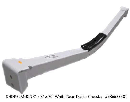

On further reflection, I would unbolt the rear drop cross member and bolt on replacement V cross member then attach keel rollers and bunk brackets.
I don't like how the low clearance of the trailer to the ground.
Here is the Shoreland'r part from Eastern Marine.
https://www.easternmarine.com/shoreland-r-painted-rear-trailer-crossbar-sk6683401-1
Fig. 9. Replacement Crossmember for trailer.

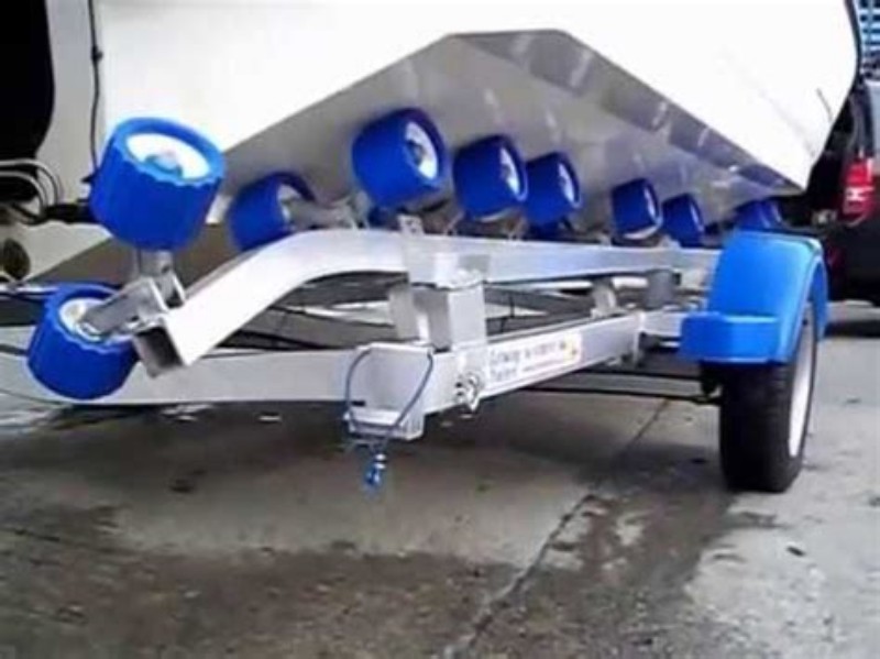

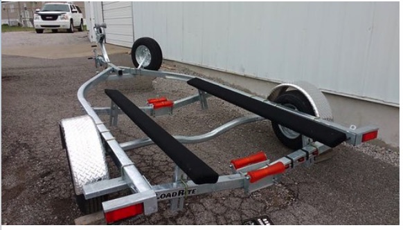

Roller bunks provide the best of both worlds.
Roller-bunk product
Re: Urgency to Change to Bunk Trailer from All-roller Trailer
Postby jimh » Wed Mar 03, 2021 8:41 am
The all-roller assembly pictured above is a variation of the floppy-roller designs of the past.
I have never seen any endorsement for that product from Boston Whaler, nor availability of the product on a trailer supplied by Boston Whaler with their boats, nor read any report of the product being used with a Boston Whaler classic-era 17-foot hull, nor actually ever heard of the product before now. I have not seen the product used by any major OEM trailer manufacturer such as E-Z-LOADER, LOAD-RITE, LOADMASTER, SHORELANDR, EAGLE, or KARAVAN.
As a general rule, the more moving metal parts that must be immersed into water for the purpose of launching or loading a small boat, the more problems are likely to occur. The above generalization also applies to plastic parts that must bear weight.
Postby Phil T » Wed Mar 03, 2021 3:42 pm
The photo above showing the blue rollers is more typical of European or Australian trailers which have rollers situated aft of the transom and slightly below and the welded frame rather than U bolt attachment method.
Limecc
Posts: 7
Joined: Tue Mar 02, 2021 5:11 pm
Postby Limecc » Wed Mar 03, 2021 4:31 pm
Roller bunks are not common in the UK, but are gaining popularity. Having double the number of rollers means the weight borne by each is halved and they probably won't deform the hull.
[Roller bunks ] are unlikely to ever come in a [Boston Whaler boat package]. To keep costs as low as possible to increase sales makes business sense. Before one of the major US trailer manufacturers sees the aftermarket opportunity and starts offering their own version is just a matter of time.
There is also another variant using roller banks fastened with U bolts. They can be retrofitted in place of the regular 4 roller carriages. Yes they are more expensive but if it means you don't have to dip the car in salt water, it could be cheaper in the long run.

I've decided to replace the all-roller trailer with a new LoadRite trailer with adjustable bunks and added keel support with rollers or pads on the cross members.
Is aluminum or galvanized steel preferred?
The LoadRite models I've narrowed to are 5S-17245090VT (steel) and LR-AB17245090T aluminium).
There is an addition cost of $500 for aluminum.
The trailer comes with the PVC side guides, fender steps, and the bunks pivot on swivels.
Postby Phil T » Thu Mar 04, 2021 5:12 pm
I have owed two Load Rite Elite trailers, the second purchased 2 yrs ago. They are very good.
The 5S- means it is a 5 Starr model.
If you have tight storage location, go with galvanized. They have a shorter total-legnth-overall.
Trailer prices are inflated due to covid. Expect to pay around $2,200 for the 17245090VT.

Postby routlirh » Fri Mar 05, 2021 7:39 pm
Phil - what is the model of the [LOAD-RITE] trailer you shared [in Figure 3]?
Postby Phil T » Fri Mar 05, 2021 8:23 pm
The photo of the Load Rite trailer above is my personal trailer.
It is a Load Rite Elite - Model #18240096VT. It has a capacity of 2,400; Torsen Axle, 14" radial tires, 72" between fenders and an overall legnth of 20'4".
https://www.loadrite.com/trailers/load-rite-galvanized-single-axle-bunk-17/#
I admit it is a bit beefier than necessary for a 17' classic hull. I had the same model under my 1991 Outrage 17 in Maine and it was fault-less, hence the purchase of the same model for my 1992 Outrage 17 I I purchased several years ago.

I have a Shorelandr galvanized bunk trailer made in 2003. The bunks were bare 2X6 boards when I bought the 2006 180 Dauntless boat.
I first carpeted the bunks, but the boat didn't slide well. Then I placed a teflon-like cover--I don't remember the trade name--over the boards because they advertised the boat would slide on and off very easily. It really didn't make much of a difference.
If what I read in one of the post replies is correct, would installing keel rollers be effective in getting the boat to slide on and off better?
Would 8-inch wide keel rollers be better than the 12-inch wide rollers?
Postby ConB » Tue Mar 30, 2021 9:49 pm
I have a carpeted bunk trailer. I spray silicone on the carpet. The bunks are slippery enough that I do not unhook the winch until the boat is over water.

Postby jimh » Tue Mar 30, 2021 11:08 pm
tlsch377 wrote:Would 8-inch wide keel rollers be better than the 12-inch wide rollers?
No.
Postby jimh » Tue Mar 30, 2021 11:09 pm
ConB wrote:I have a carpeted bunk trailer. I spray silicone on the carpet. The bunks are slippery enough that I do not unhook the winch until the boat is over water.
I discovered that same property of silicone spray on carpeted bunks very late one night when launching the boat around 2 a.m.
