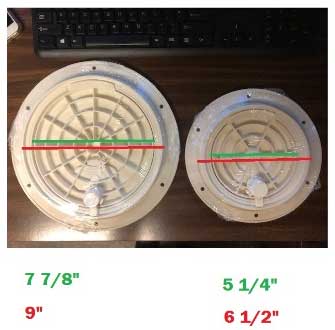

Postby Bayrat723 » Mon May 03, 2021 1:05 pm
Both BEACON MARINE and NAUSET MARINE carry a drop in replacement [as in these parts will fit the existing large hole in the deck] for the 6-inch and 8-inch circular deck access plates made by Viking.
Below are images received from BEACON MARINE.
Fig. 1. Replacement circular deck access plate with dimensions. Underside view
Fig. 2. Replacement circular deck access plate with dimensions. Topside view.
[Moderator's note: a duplicate image has been eliminated. The images have been cropped to reduce excessive white space and duplication.]

Postby fno » Mon May 03, 2021 10:01 pm
I went through [replacement of a circular deck access plate made by VIKING marine] recently for my 2005 210 Outrage.
Sue had exactly what would fit in the space.
IMPORTANT DIFFERENCE BETWEEN ORIGINAL AND REPLACEMENT:
The hole pattern is different so you will need to drill new holes.
I suggest fixing the circular deck access plates with 316 stainless steel machine screws fastened to Nylock nuts underneath the deck.
Pop-rivets are not up to Dick Fisher's standards--someone in Florida thought they would be okay.

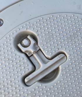

Postby pred02 » Wed Jun 08, 2022 6:59 am
I believe the answer to your inquiry is already given above: Contact Sue at Beacon Marine.
I have contacted Sue. There are no Viking T-Bar replacements or covers. You need to replace the whole mechanism not just the cover which makes the job not worthwhile given the way its adhered to the bottom.
I now plan to find a second hand Viking TPL-8 or glue the broken T-Bar.
Q3: What other alternatives can be used to repair a broken T-bar?
Fig. 3. T-bar close up, which appears to be broken.

pred02 wrote:Q3: What other alternatives can be used to repair a broken T-bar?
I think you have already postulated the two most likely methods.
With regard to use an adhesive ("glue") to joint two pieces of the T-handle: you should contact the manufacturer to see what material was used to make the molded T-bar component. Some plastics can be repaired with a strong adhesive, but often a specific type adhesive must be used with specific plastics. Also, I would consider strengthening the joint by adding a metal locating pin or perhaps two pins. An internal pin might help prevent fracture of the adhesive joint when a strong pull is applied to the T-handle.
pred02 wrote:...to replace the whole mechanism...makes the job not worthwhile given the way its adhered to the bottom.
I don't understand how you have determined the amount of adhesion between the circular deck plate access outer ring and the deck. I doubt that Boston Whaler installed the circular access deck plate outer ring in a manner that prohibits forever it being replaced.
Regarding the "worth" of replacing the entire circular access deck plate, do you have a figure for the cost of a new deck plate? Considering the cost of a newer Boston Whaler boat that uses these fittings, I cannot image that the cost of a replacement circular deck access plate would be so high as to not be worth making the repair.
Re: Viking Marine Out of Business: PTL-6, PTL-8 Circular Deck Access Plates
Postby jimh » Wed Jun 08, 2022 11:29 am
If Figure 3 illustrates the broken T-handle of the circular deck access plate under discussion, it looks like to replace just the T-handle you would have to drive out the pin that is holding the T-handle part to a shaft that must operate the locking mechanism on the other side of the plate. Since you cannot get access to that pin with the T-bar already installed on the plate, you must need to release the shaft from the mechanism on the other side. Or perhaps there is some element of the whole assemble that does not permit that. Perhaps the components are welded together during assembly. Perhaps that is why the manufacturer does not offer just replacement T-handle parts.
