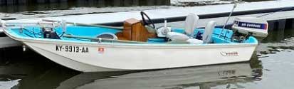

Fig. 1. Boat static trim.

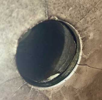

Fig. 2. Drain outlet with flared brass tube eroded away.

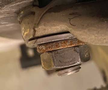

Fig. 4. Port upper outer engine mounting nut seen in extreme close up from overhead.

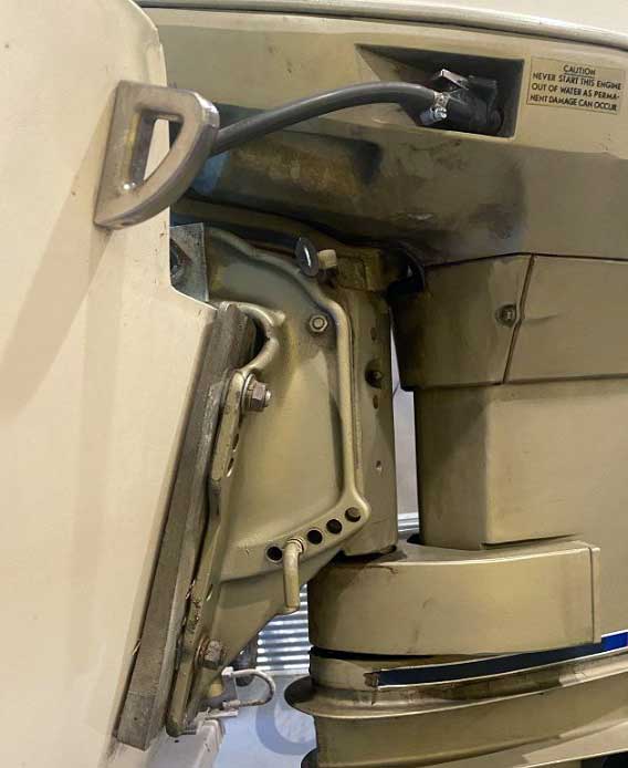

Fig. 5. Engine mounting with shim, showing engine mounted in lowest engine height position.

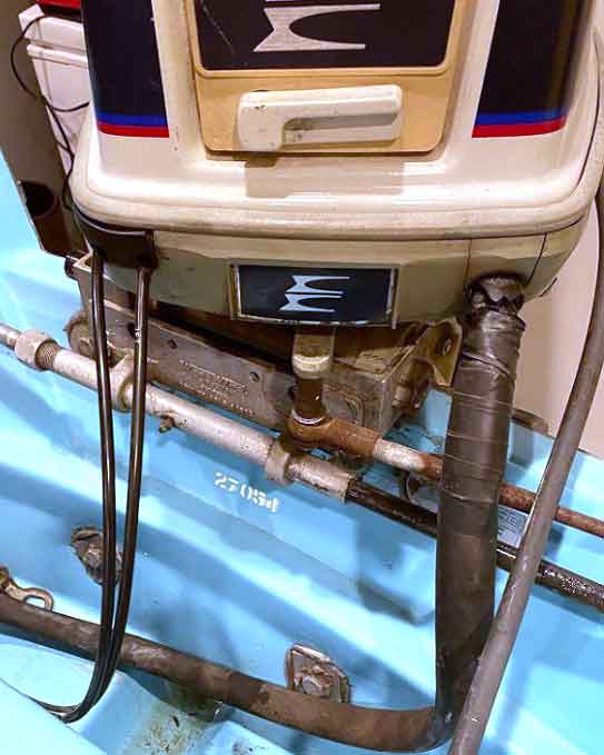

Fig. 6. Engine mounting cockpit view.

A3: Indentation of an engine mounting bolt washer into the gelcoat and laminate could just be a result of over-tightening. A mismatch between the surface plane and the bolt orientation could concentrate forces onto one side, as can be seen in Fig. 2.
A4: A metal plate that spans between the two upper engine mounting bolts is often used to spread the load of the engine on the transom.
A5: Over-tightening of an engine mounting bolt can compress the transom laminate.
A6: Figure 1 is so small that assessment of the static trim is difficult, and the boat is not photographed at a good angle for assessing the trim. It looks a bit bow high. If that is a 55-HP engine, that is far above the maximum engine power of 40-HP rated for a 13-foot hull, and that static trim is bow-high is not surprising.

Pslater wrote:The 13-footer needs a new drain tube.
See advice in the FAQ for information about procedures for installation of new brass drain tubes at https://continuouswave.com/whaler/reference/FAQ/#Q12

In FIgure 5 a shim is shown that creates a change in the angle of the engine mounting. Usually a shim is used to permit more tuck-in or trim-in of the engine. This one seem to be mounted to create more trim-out, which generally is not necessary.
Since you plan to remove the engine, you should check the engine mounting hole locations on the transom. The engine appears to have the classic OMC and BIA engine mounting hole layout, so the transom mounting holes should be in the BIA layout. For more advice see the FAQ at Q8.
