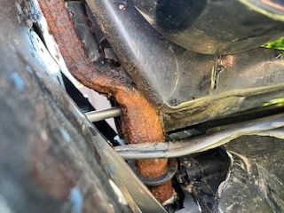

On a 2006 Mercury Optimax 75 water comes up and out the top of the swivel assembly where the shift shaft threads.
Fig. 1
Fig. 2.
Fig. 3.
I only see this excess water during flushing, at boat speeds greater than 30-MPH, and at engine speeds greater than 5,000-RPM.
Is this normal?
Did I miss a gasket or seal when I removed lower unit to replace water pump?

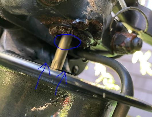

The tube is hollow and if the water running by the bottom while unerway somehow causes the water to rise from the tube, I'd say this happened before, but you never noticed it. Some motors have a foam like dounut that sits in or on that tube or a rubber boot for this reason, but depending on the design, it could interfere with your shift shaft and probably the reason it's not incorporated on your motor. I'm noticing your steering tube is steel and that may also be a reason not to have the foam dounut as use in salt water would saturate the foam and it would act as a rust accelerator when the boat is stored.
After watching your second presentation make sure the copper tube that seats into the waterpump housing is seated correctly.

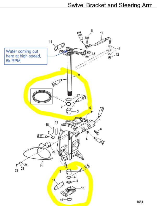

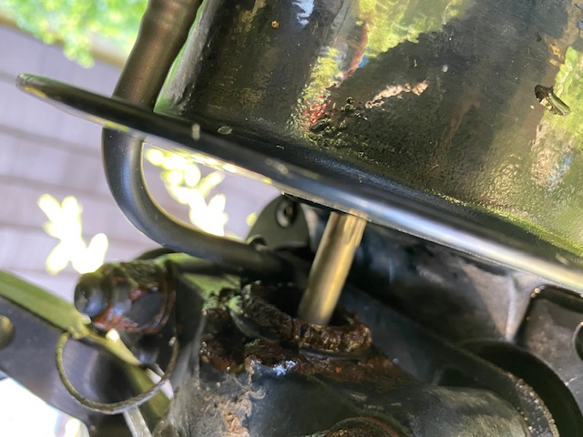

Understood, the steering tube is not connected to the water pump but somehow water is projecting itself up the steering tube towards the swivel only at high speeds. You might be right, maybe I just never noticed before but something still seems wrong. I'm wondering if that's why my swivel bracket is so rusted?
Like you say in your last comment, the water seems to be coming up (blue arrows in the image below) from where the shift shaft spline enters the lower unit. What would be causing this? I am not sure what the copper tube you are referencing is? Is it the "Pin dowel" I have highlighted in the parts diagram?
Could the "donut" be a solution? Would the "donut" be located where I circled in the picture?

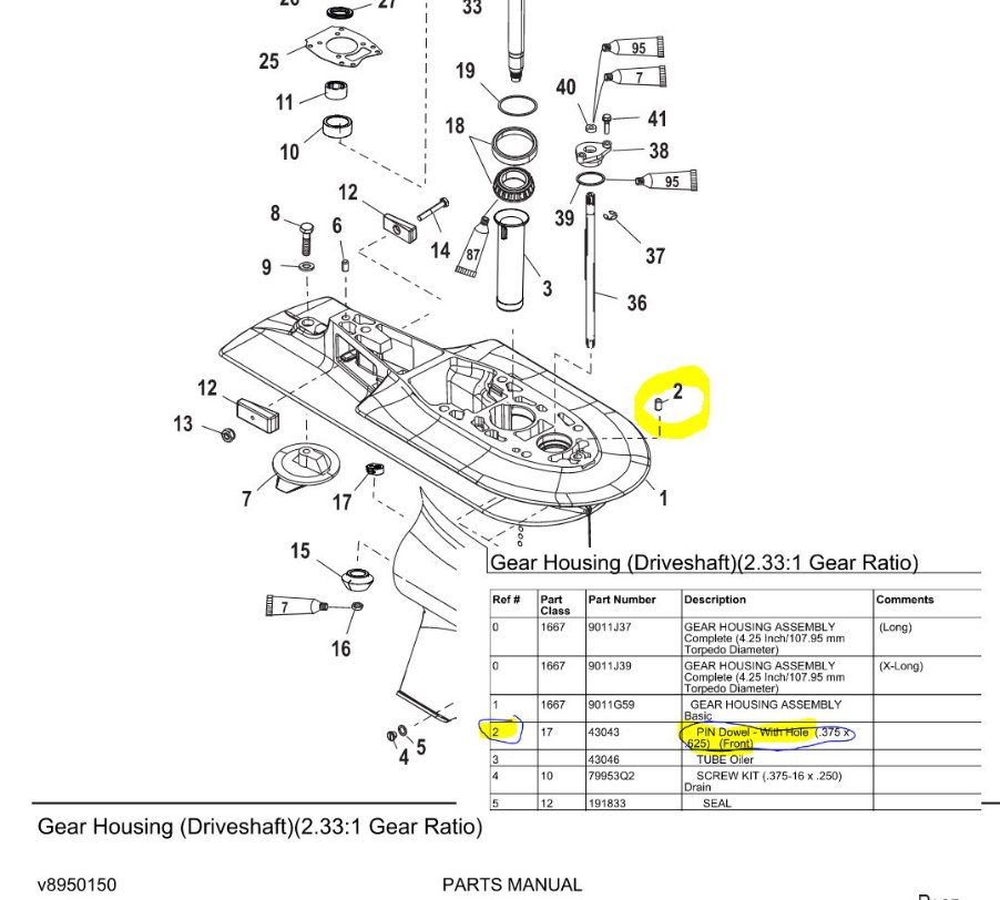

In Figure 3 what is the legend for callout 9?
CiancioloNauset71
Posts: 13
Joined: Wed Sep 06, 2017 8:09 am
Re: 2006 Mercury OptiMax 75 Water in Swivel Tube
Postby CiancioloNauset71 » Thu Jul 08, 2021 9:39 am
In figure 3, call out 9 is the Swivel Pin Assembly (Part #99661A35)
