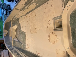

On my 1983 15 Striper the hull gelcoat wasn’t chipping off, but it did have significant crazing throughout.
Fig. 1.
Fig. 2.
Fig. 3.

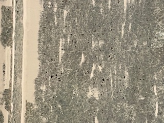

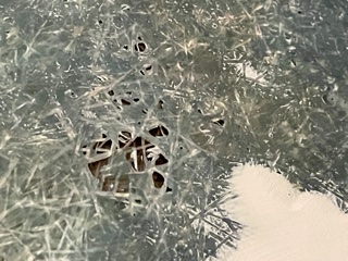

In literally every place I found a gel coat crack, I removed the gel coat completely down to the laminate below, and I found a pinhole void where I assume was an air pocket. To avoid having these cracks print through my new paint job, I removed every one with a belt sander or an angle grinder with a conical shaped 80-grit sanding wheel. In many places, there were so many cracks, I just removed entire sections of gel coat.

Based on your illustration at Figure 3, I would describe the defect as the laminate layer below the gel coat layer was poorly infused with resin.
The hull was molded in 1983, and that is 38-years ago. I do not have any basis to comment on how prevalent air pockets or poor resin infusion occurred in 15-foot hulls molded in 1983.
Regarding where cracks might occur in the gel coat layer due to air pockets: I have a Boston Whaler boat molded in 1990. I have found that an air pocket under the gel coat layer where there is no bond between the gel coat layer and the next layer of the laminate will tend to produce a crack in the gel coat if there is any impact or stress on that area of gel coat. However, I would not describe these cracks as crazing nor would I say there are prevalent throughout the hull.
I have only found two small cracks in the gel coat. One was in an area that was typically covered by another component so it was not visible. The crack erupted when threading a screw fastener. The second was in a section of the deck where an impact to the deck probably created the crack.

The problem you’re experiencing is not due to air pockets, but likely due to the laminate under the gel coat not being wetted-out properly during molding.
