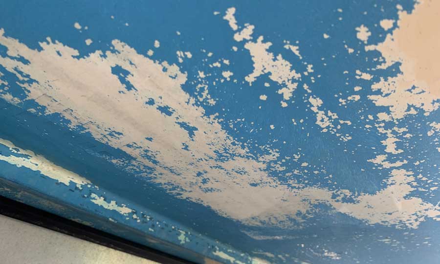

Postby ChrisL » Wed Sep 15, 2021 1:07 pm
Fig. 1. An image of a hull bottom that was posted with no explanation or caption or reference in the text.
jimh wrote:A method using air-blasting with mild abrasive powder, often called "soda-blasting", can remove bottom paint from a hull without [img]causing harm to the gel coat. The gel coat layer will be abraded somewhat by the soda blasting and will no longer have a gloss finish, but there should be no chemical reaction.
Q3: [after bottom paint has been removed using soda blasting, can you buff the gelcoat back to a shine?
Q4: or will the gel coat first require sanding?

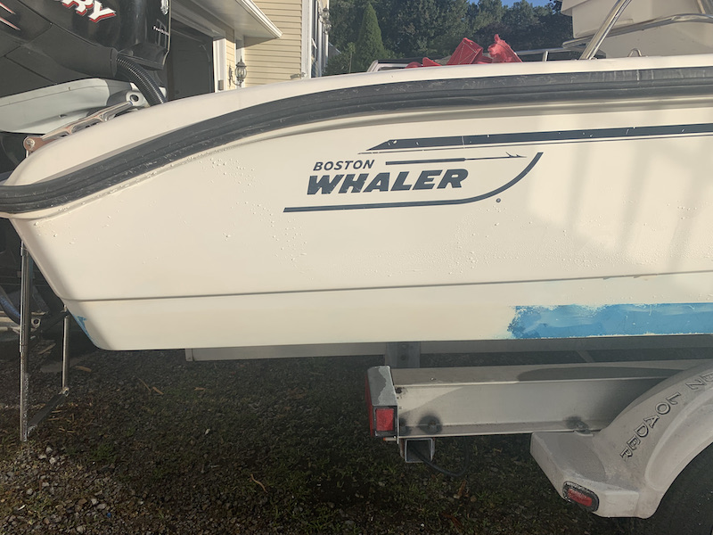

Postby ChrisL » Tue Sep 21, 2021 9:41 pm
After receiving a quote of $1,700 for soda blasting, I decided to buy a tub of Peel Away.
Peel Away worked amazingly well. A quick buff with a 3M cleaner wax was all that was needed to restore the factory shine.
Fig. 1. an area of bottom paint removed using Peel Away.
