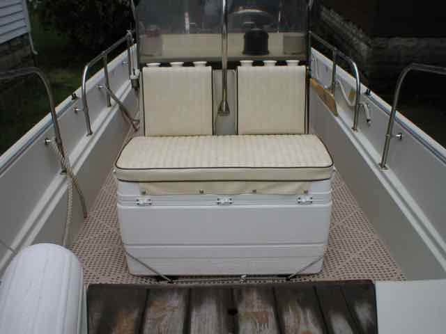

If you have rod back cushions, install the new cooler backwards. It allows the cooler to open without binding on the bottom of the rod cushion.
These are new rod and cooler cushions (Halls) with a new 94qt cooler on my 1987 Montauk.
