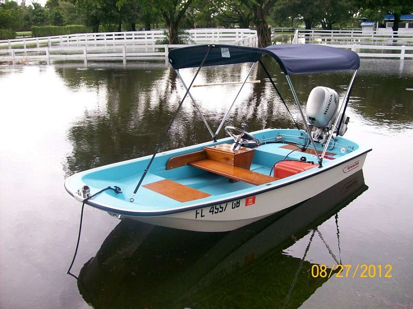

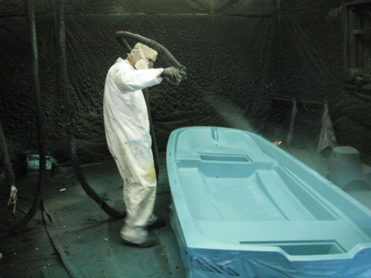

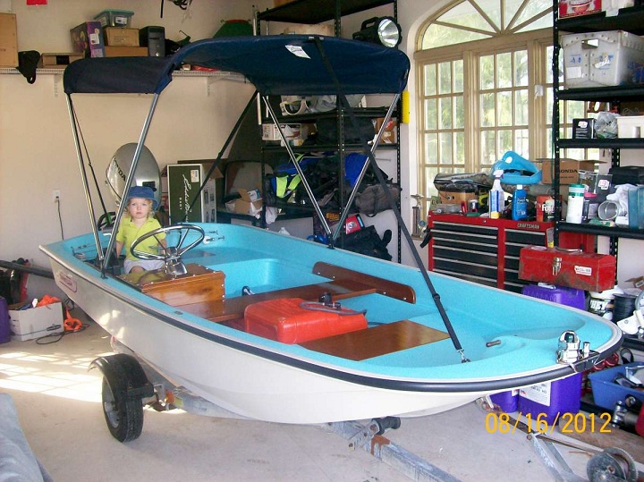

The latter is the way to go--trust me. If it were something super rare would be the exception. Here is a SPORT 11 Sport I did three years ago. Looked like new when it was done.

Postby Jefecinco » Tue Nov 03, 2015 8:36 am
The LineX certainly looks good and provides a fairly non-skid surface throughout. It even has a shine, or at least the black LineX bed liner in my truck has a nice gloss. But it will never look quite as good as gel coat or two-part paint. Practicality and functionality are its strong points. Not every LineX franchisee has the skills needed for the job. If you plan to use this method, shop carefully. It may not be the most comfortable surface to spend a lot of time with when wearing shorts or going barefoot.
