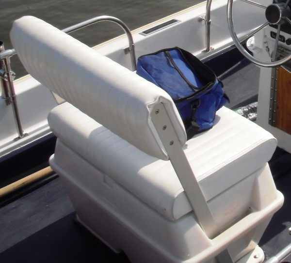

The [way to have success when applying SEM Color Coat aerosol paint to paint old vinyl cushions] is to clean, clean, clean [the old vinyl cushions before applying the new SEM Color Coat aerosol paint]. [There can be] no dirt or oils on the [vinyl cushions]. [Apply SEM Color Coat aerosol paint] on a warm sunny day. No wind. Light coats only. Wait ten to 20 minutes between coats. Never do thick coats.
Cushions will need to be done one side at a time obviously, unless you can hang it from something.
Once you are happy with the coverage do not touch the cushion. Let the cushion sit for a few hours.
If you cannot take the cushion inside then cover the cushion.
If you can smell an odor of the [SEM Color Coat aerosol paint] coating, then the coating is still curing. Let the coating cure.
If you can't get an exact color match, then get a close color match.
Changing the color of a cushion to black from white is a problem, or vise-versa. More coats will be needed.
On my flip-back seat I use the Sailcloth White color. I only need to touch up the paint with a quick coat maybe every three years.
If the preparation for painting [SEM Color Coat aerosol paint] was done well then the [SEM Color Coat aerosol paint] will be very durable.
I do automobile seats with [SEM Color Coat aerosol paint] and that is probably the hardest use of all.

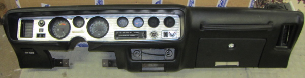

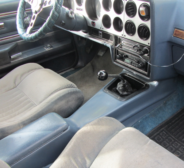

More about [SEM Color Coat aerosol paint]:
Many years ago [SEM Color Coat aerosol paint] was advertised as "vinyl dye".
[SEM Color Coat aerosol paint] did not actually dye the vinyl and eventually the name changed to [SEM Color Coat aerosol paint], but [SEM Color Coat aerosol paint] is the same thing [as "vinyl dye"].
[SEM Color Coat aerosol paint] is a flexible paint that will not crack from movement.
I use [SEM Color Coat aerosol paint] on automobile interior vinyl parts such as dashboards, door panels, and seats.
Even on seats [SEM Color Coat aerosol paint] is very durable as long as the vinyl has been scrupulously cleaned during preparation. A degreaser such as Simple Green is [a] perfect [cleaning agent].
I use an old school scrub brush with stiff bristles to get into the seams and crevices. Then I rinse off with fresh water and let [the cushions] dry in the sun for a long time.

- Fig. 3. Flip-back seat painted Sailcloth White #15603.

OLD--thanks for the information about SEM Color Coat aerosol paint. I hope that was the product that was being asked about. The initial post just described the product to be discussed as an "SEM marine product."
The automotive surfaces you re-painted with SEM Color Coat aerosol paint look okay in the low resolution images you posted. The boat seat looks okay, too.

Yes Jim, I assumed the same thing, that the OP was asking about the Colorcoat product. I buy it at an old school mom-n-pop auto parts store that carries auto paint and body working supplies. They had the best price and color selection. Also most dedicated auto paint supply shops carry it. I have also found it on the internet from auto body supply sites as well as Ebay and Amazon. Prices can vary wildly. I am used to getting a 12oz aerosol can for around $10 but I have seen it as high as over $20. You need to shop around. The console/dash blue color in fig 1 was difficult to find as it was a discontinued color. But I found an entire case lot of it from an auto body supply place in Ohio on the internet. They were happy to get rid of it for a great price. As for coverage, one can will go quite far if you stick to the thin coat instructions. I often overdo it and use an entire can on a single front car seat because I am usually changing the color drastically. If you were just renewing a color such as Firethorn Red, which GM used a lot, you could cover two front seats and then some. I realize that my pictures were not the best. The finished look is really quite good since it is fresh paint.
