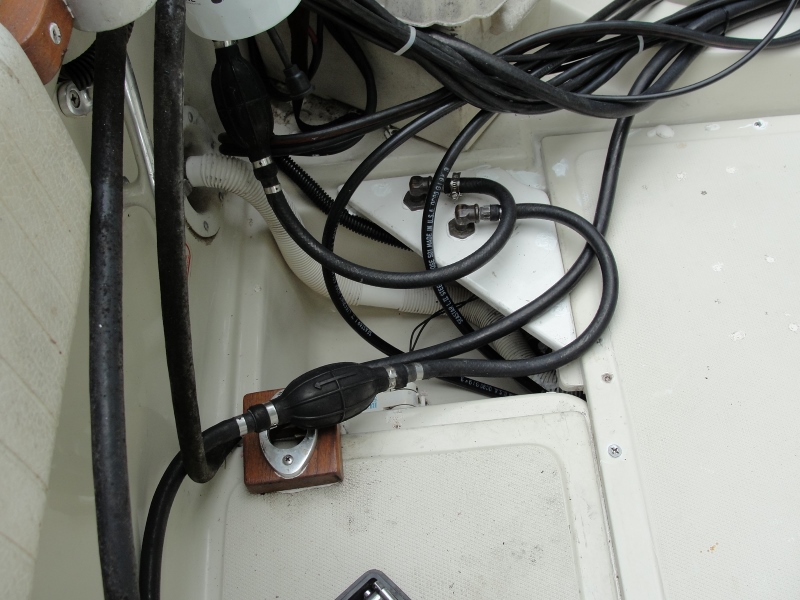

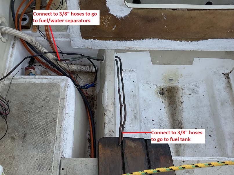

Give me advice for running fuel hoses from the fuel tank to the engine [on a 1987 REVEVGE 22].
Fig. 1. Photo of rigging.
As seen in Figure 1, at the moment the are two small-diameter copper flexible tubings along the starboard side of the aft below deck livewell running toward the engine from the fuel tank,
I remember I read somewhere "no copper pipe on boat.”
Q1: what should I do now?
Q2: should I keep the copper tubing?
Q3: should I use stainless steel tubing?
Q4: should I use brass pipe?
The present fuel line rigging is:
Tank -> 3/8-inch hoses -> copper pipes -> hoses again -> engine.
I would like to add a fuel-water separating filter on the gunwale [upstream] of the engines.

rnln wrote:I remember I read somewhere "no copper pipe on boat.”
You should give the URL to an authoritative source for that prohibition in federal regulations that you think you read once somewhere.
rnln wrote: Q2: should I keep the copper tubing?
If you are going to overhaul the whole fuel delivery system, discard the copper tubings and any rubber hoses. Run new USCG-approved rubber fuel hose from the fuel tank pick up fitting, stop first at the fuel-water separating filter.
DO NOT MOUNT THE FILTER ON THE GUNWALES. Mount the filter to the inboard wall of the transom or the hull sides.
After the filter, insert a very good OEM quality new primer bulb so the direction arrow on the primer bulb points upward and toward the engine. The bulb should be close to the engine and in a handy location that can be reached easily.
After the primer bulb run more hose to the engine and into the engine cowling to the appropriate point in the engine fuel system.
Read about USCG fuel hose requirements, but don’t get confused about rules for newly built boats compared to existing boats. And be prepared to be shocked at the price per foot.
rnln wrote: Q3: should I use stainless steel tubing?
No—I have never seen this used on any outboard engine because the engine has to pivot and tilt.
rnln wrote: Q4: should I use brass pipe?
No. Where would you get flexible brass tubing.
The fewer connections in the fuel hose runs, the better the system will be.

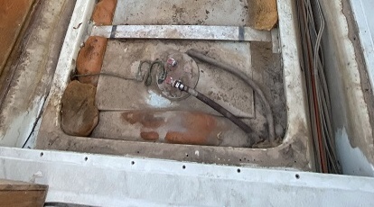

Yes. This is original when I first lift up the floorboard.

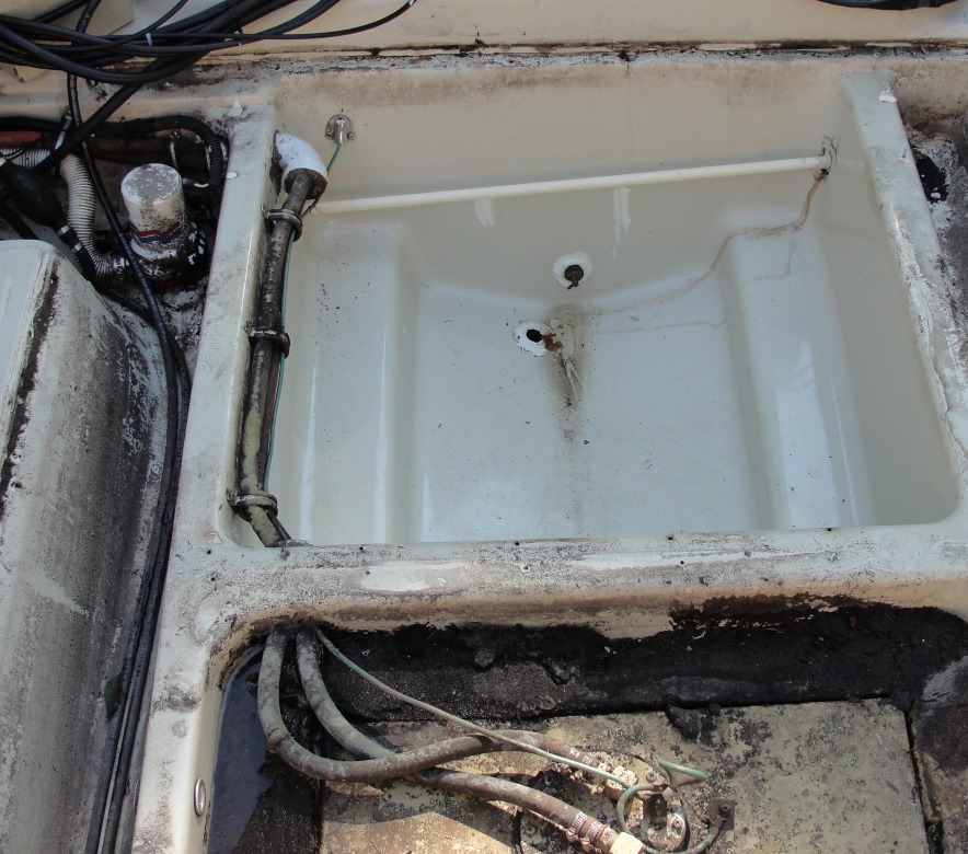

Fig. 2. The original fuel line rigging.

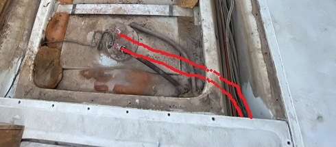

My boat was rigged with copper fuel line mixed with rubber hoeses as jimh described above.
However, I see that the fuel lines can come out directly from the fuel rank outlet to the rigging tunnel then curve to the sump area, and in this way there will uninterrupted rubber fuel lines going from the tank all the way to the filters, without having a 90-degree bend,
Q9: Do you think [the route shown below in Figure 3 is a better approach?
I will have to seal the existing hole in the live bait well and drill two more holes on bulkhead between the tank cavity to the rigging tunnel
I plan to line the new holes with fiberglass tubes. I will epoxy the tubes and smooth them out.
I am afraid the hoses will rub on the tubes and will be damage soon or later.
Q10: will rubber hoses run through fiberglass tubes eventually fail due to abrasion?
Fig. 3. Proposed routing of rubber fuel hoses.

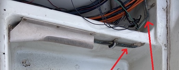

Figure 4 below show the original installation of the copper fuel lines.
Fig. 4. The original installation of copper tubing for intermediate segment of the fuel lines.

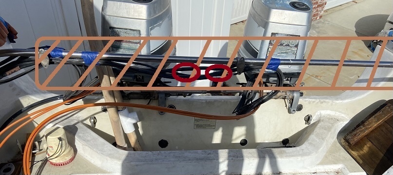

I plan on installing the filters on the gunwale (red circles) because I saw some pictures of people doing so. But if you think it's a no no, I can do the second choice (blue circles) on the inwale.
Fig. 5. Proposed locations for fuel filters.
Please let me know what you think.

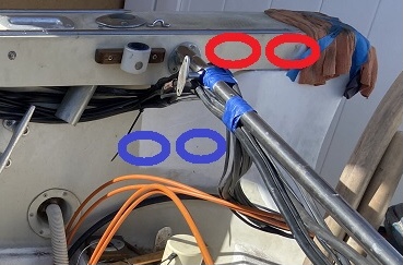

Or as shown in Figure 6, I can mount a 2x6 wood piece on the stainless steel bar and install the fuel filters behind it (purple).
Thanks.
Fig. 6. Alternate location for fuel filters.

My advice for the location of the fuel filters is on the hull inwales, as seen in Fig. 5 with blue circles, but slightly more forward than indicated. If the hull inwale is curving there, you could make a fairing block to present a flat surface to the filter mounts. When mounting a canister-type filter, be sure you leave enough room below the filter to allow the filter to be unthreaded and removed without spilling out a lot of fuel into the boat.
Also, you could use smaller canister filters because the flow rate of fuel for a 70-HP engine will not require the typical rather large canister filters often used.
Another option is to use one large canister filter with a filter manifold that allows two inlets and two outlets. But using one large filter for both the inlet hoses and the outlet hoses will eliminate the total redundancy of using separate filters. If you are boating in areas where the gasoline for sale is not the best quality, perhaps two filters will be better.
My own boating experience is to have never had any bad fuel, and I have never had to change a fuel filter.
In addition to poor gasoline, another source of contamination in the fuel can come from sediments in the tank bottom. Sediments can exist without causing problems for a long time, but the sediments can be stirred up by operating the boat in rough seas. This occurred to a friend of mine when be bought a used boat that had been sitting for a long while without use; the fuel tank had a lot of sediment in it, and after ten miles in rough seas, a fuel filter clogged with filtered sediment and one of his engines stalled. His boat was rigged with twin engines and two independent fuel lines with separate filters. That allowed the voyage to continue on one engine to the nearest port, where repairs could be made.

As seen in Figure 2, that second fuel line connecting to the fuel tank looks oddly done. I would examine the tank fitting there very closely to see what was done.

As seen in Figure 4, I suspect the connection between the rubber hoses from the fuel tank and the copper lines was made underneath that plastic cover on the left of the photo.

jimh wrote:As seen in Figure 2, that second fuel line connecting to the fuel tank looks oddly done. I would examine the tank fitting there very closely to see what was done.
Oh, sorry, I didn't explain. I took the photograph in Figure 2 right after I lifted up the center deck molded section that covers the fuel tank cavity. One of the hoses is not connected. The [second] fuel pick-up port was closed off.
Looks like the fuel supply from the fuel tank was using only one of the two fuel hoses to the engines.
The seller of this 1987 REVENGE 22 told me he emptied the fuel tank before he let the boat sit unused.
