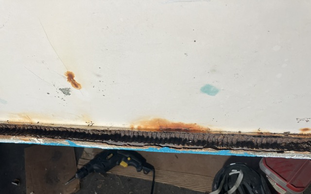

I'm restoring an ancient13-footer with a hull number in the 4000s, which should make it a 1960.
The lip on the bottom of the gunwale seems to have been formed over something ferrous, perhaps a spiral conduit like BX cable or similar judging from the traces it left behind. It has of course rusted away completely, leaving a hollow core of rust inside the gunwale, except in the places where the gunwale has collapsed and there's just rust-stained foam. (in those cases it collapsed from the bottom or side - the top side is fine)
Give me advice on how to remove the rust stain and repair the gunwale laminate.
plan to slit the side to get access, vacuum out the bulk of the rust, put in rust neutralizer, then foam, and then laminate over the repair area, I have no experience dealing with a repair like this.
Also, note I'm going to be installing the more modern three-part rub rail, rather than the old one-piece rubber one.

Your analysis that the source of the rust is from a metallic spiral electric cable is correct. Boston Whaler used BX-cable in the early 13-foot boats.
I don’t know the precise reason for the use of the steel-sheathed cable, but I believe the spiral metal sheathing had something to do with venting air from the process of filling the hull with foam. Bob Dougherty described this to me in person once while we were chatting at a boat show years ago.
The remedy you propose sounds very workable. But you should experiment with the “rust neutralizer” first in a small area to see if there is a need for it and if it causes more harm than good. Perhaps you can find some paint that will help stop future rust. Instead of foam you could use epoxy resin thickened with a low-density filler. Then use epoxy resin for the lamination and top coat, adding white pigment to the resin for the final layer.

Figure 1 shows rust, looking down with the boat flipped. The starboard side doesn’t have any wiring inside the housing; not sure about port.
Fig. 1. Rust stains.
I don’t know when BX cable was banned in Massachusetts, but it was used in the vast majority of houses here that were electrified after construction, except for a few of the fanciest places (i.e. first to get electricity) which were wired with knob and tube.
BX sheath would have been a readily available and cheap material back then, and I doubt Boston Whaler were worrying about how it would hold up after 65 years when it was only their second or third year of production.
