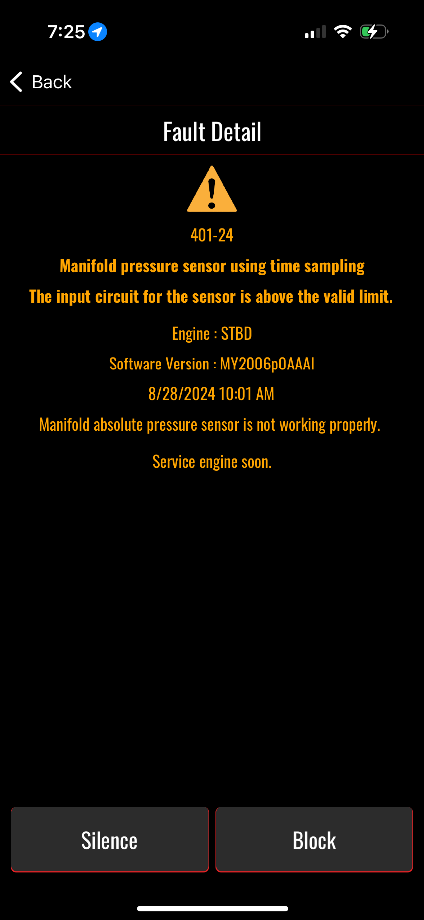

[Dear Reader: please help with any suggestions on how to diagnose the cause of a MAP service code on a] Mercury 60-HP BIGFOOT FOURSTROKE engine, serial number 1B004506
After two days of good angling for salmon in the Strait of Juan de Fuca, the Mercury 60-HP BIGFOOT FOURSTROKE engine had another problem: upon turning the ignition key switch to ON from OFF, I heard a dreadful LONG BEEEEEEP followed by BEEP_BEEP_BEEP_BEEP_BEEP_BEEP (six short). On the VesselView instrument a service code for MAP appears. The code says:
    401-24
    Manifold pressure sensor using time sampling;
    input circuit is above the valid limit...
    Manifold pressure sensor is not working properly.
    Service engine soon.
Fig. 1. Screen capture of MAP service code.
Apparently there are two versions of this code, one for when voltage is too low and one when it is too high. Note: this code was thrown before engine is started, simply by turning on the key.

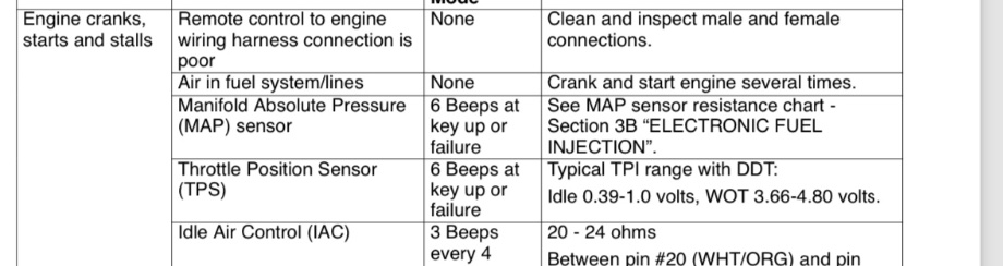

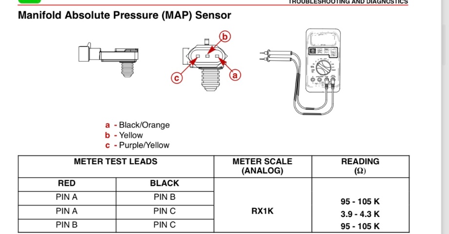

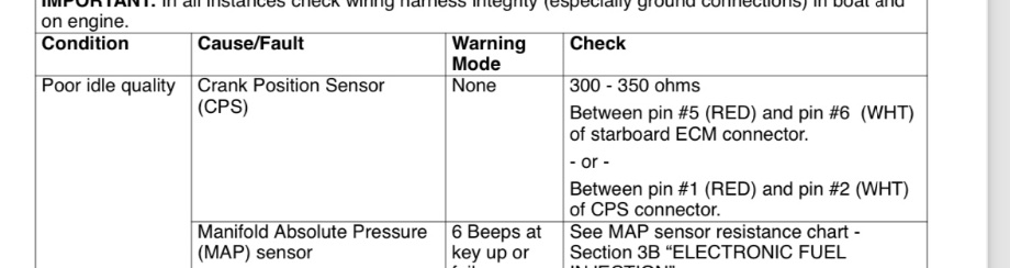

I do have the manual. Unfortunately without the DDY ($1300 tool) instructions are sparse. Attached are images from the manual. For my described state it indicates I should check the resistance on the sensor so that is what I will do… when I find my multimeter, I put it away somewhere new when I moved. :(
Meanwhile I went to go change out the sensor with my old one and the ECM. I was praying oddly enough it would still have the [problem with the engine] this morning (the [problem with the engine] persisted while on the water and after I drove 4 hours home. If I didn’t, then that would make it way harder to diagnose.
Lo and behold, turn the key on and no beeps. Starts right up. Sigh. I am going to exchange those parts out anyway and will test the MAP sensor when I find my multimeter.
