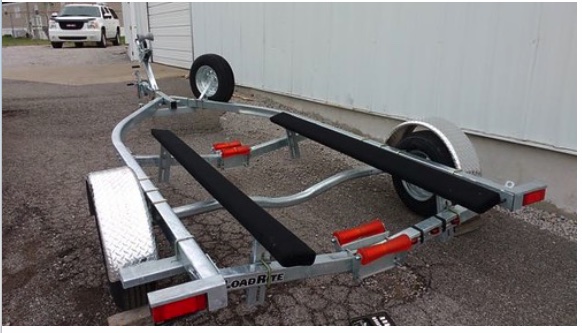

Look for a bunk trailer with keel rollers--not wobble rollers on arms.
The setup on my LOADRITE trailer is shown in Figure 1.
Fig. 1. A bunk trailer with keel rollers added in pairs to the trailer frame crossmembers.

I believe PHIL T added those keel rollers to the trailer, or persuaded the manufacturer or dealer to add them at the time of purchase.
I had a similar experience: the trailer under my REVENGE 22 W-T Whaler Drive boat was originally an all-bunk trailer. I added four keel rollers in pairs of two at two crossmembers.

Thank you Jim, I forgot to mention the keel rollers.
Loadrite does not offer keel rollers as an option, most trailer manufactureres do not either.
I used a local boat dealer to order the trailer. Since they are not familiar with Boston Whalers and did not have experience with keel rollers I purchased the rollers, brackets and hardware myself (http://www.sturdybuiltonline.com). I installed them immediately before I had the boat moved over. I adjusted the bunks/rollers at my local lake ramp at a later time.
I installed twin 12" keel rollers in the stern and twin 10" amidships. I followed the setup Larry (aka Finnegan) has, given his lengthy trailering experience.
For a 16' hull you could go with a single 12" and 10".

Thank you Jim and Phil for your helpful responses and picture! I contacted a Load Rite dealer and am going to order a trailer and add the rollers per your advice. Again many thanks.
