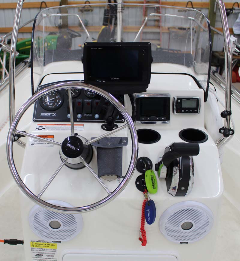

I decided to mount a chart plotter using a Ram Mount (1.5" ball) brand mount to give some versatility. I wanted to show a few pictures here.

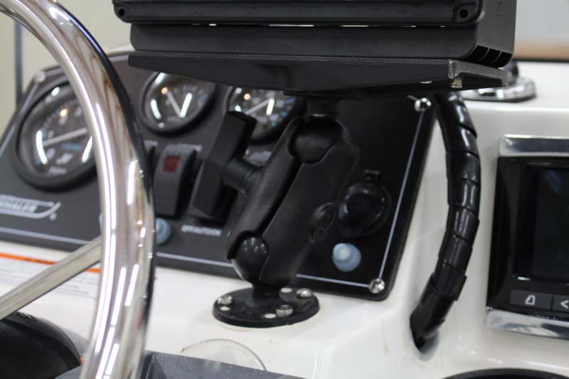

This is on a Montauk 170 and using a Garmin 741xs and could be done in different ways for other configurations. It can easily be adjusted for different angles and positions and is very stable in rough water.

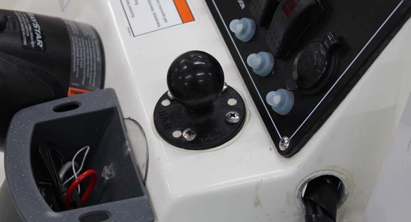

The ball is mounted using stainless bolts and nylock nuts. It has two pieces of aluminum angle iron under the console with 3M 4200 adhesive on the top and bottom of the fiberglass for stability.

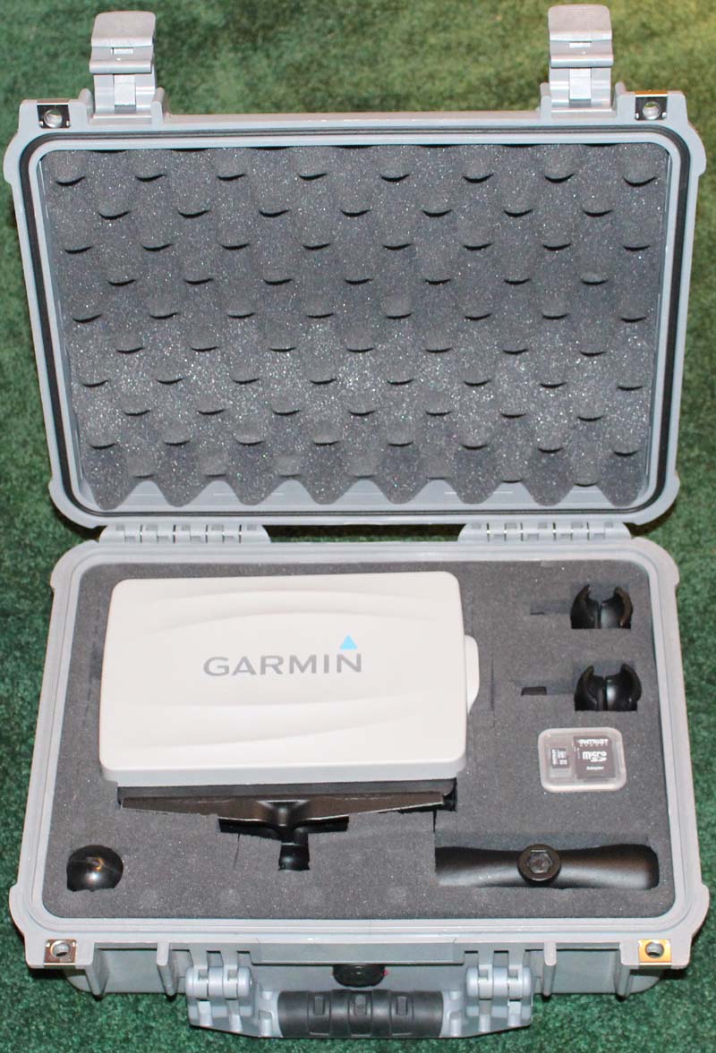

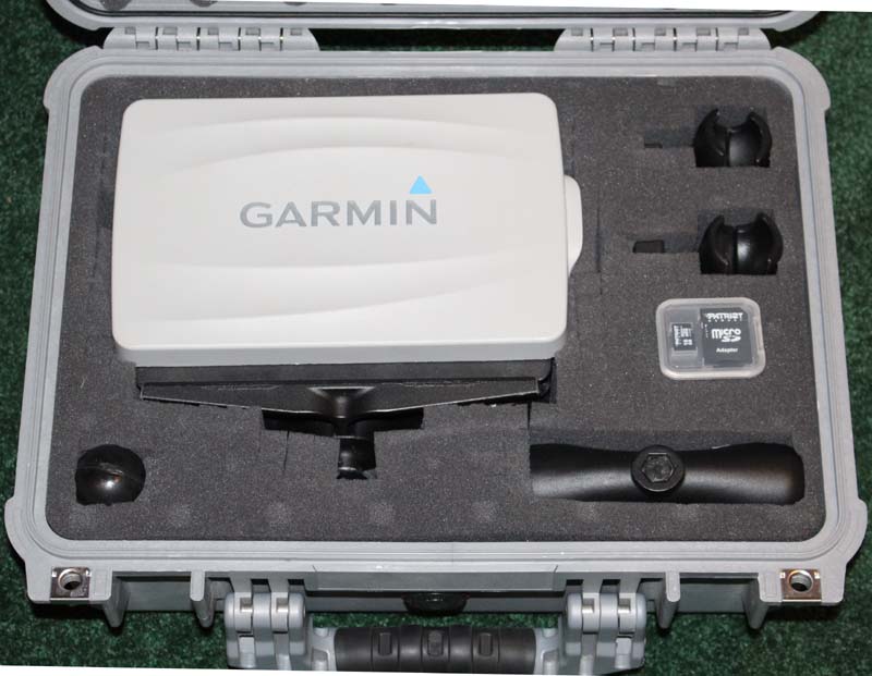

I normally take it off when travailing and store in a Pelican case.
Thoughts, questions, or suggestions, please let me know.

The reasons I mounted it there included:
- preferred not to cut a hole in the top console panel and to make cable routing easier
- this is easier to rotate, where the standard bracket is made to be fixed
- wanted to leave console top open for possible future use
- with current position it sits a little lower, obstructing less of windshield view
- with the touchscreen it is closer to the operator, making it slightly easier to use

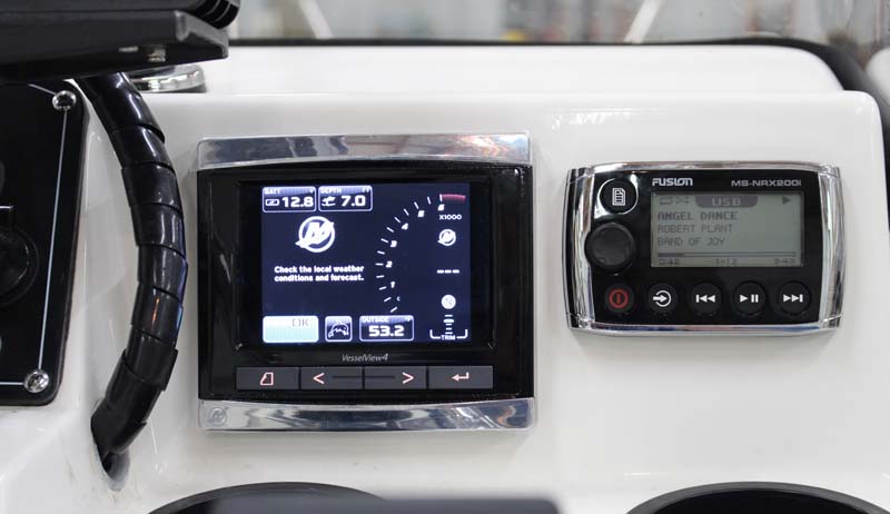

Unrelated to the mounting directly, this leaves room on the console for the Fusion black box steno remote and Mercury Vessel View 4. The Vessel View gives good support for the engine and acts as a gateway between NMEA 2000 and Smartcraft.
Vessel View and remote for under-console, NMEA 2000 connected Stereo

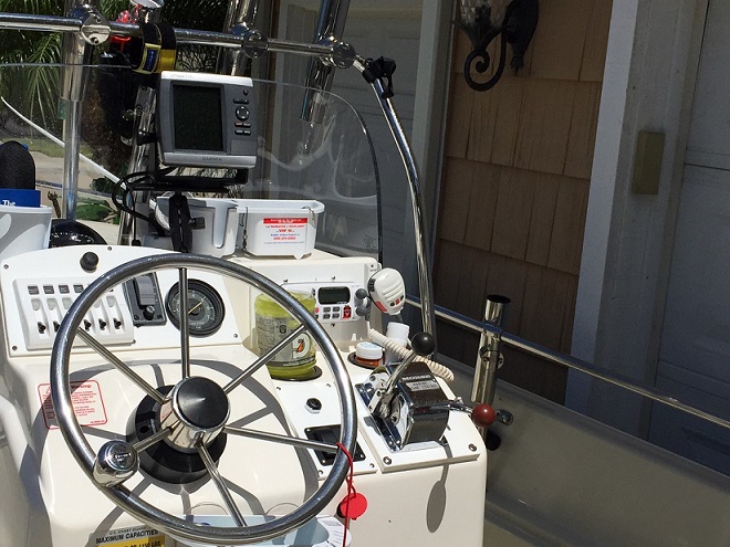

I agree RAM Mounts are a great way to mount electronics. Here is my set up. I know, my console top is a little cluttered, but I use all the space.

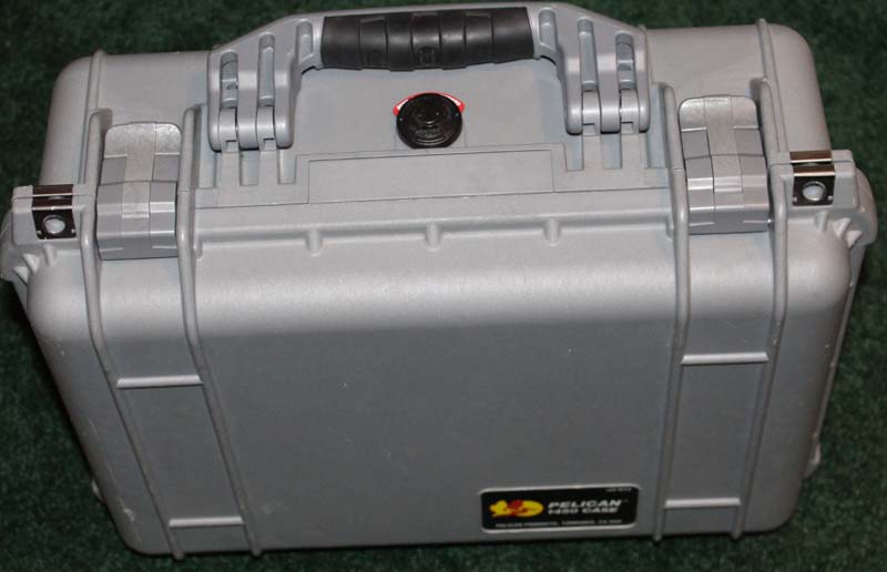

I do remove the chartplotter for security often. It gets stored in a Pelican model 1450 case for protection.
