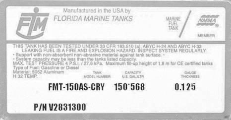

Q2: what is the volume capacity of the OEM fuel tank in a c.1986 OUTRAGE 18?
Also, I anticipate that the "tag number" refers to the field on the fuel tank label that is denoted as "Tank Model Number." Compare below with a random label from an FMT tank.
Fig. 1. A random label from a Florida Marine Tank fuel tank showing the fields TANK MODEL NUMBER, CAPACITY, and PART NUMBER.
