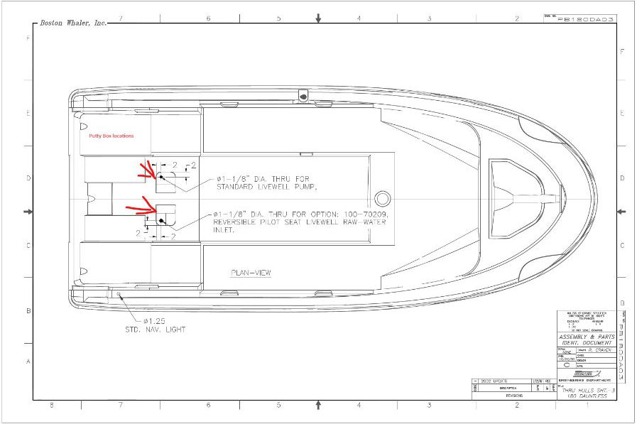

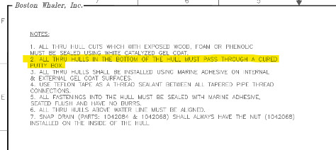

[Moderator's note: illustrations Figures 1, 2, and 3 were added to this post after several replies were made concerning what was meant by the term "putty box." Also, the through-hull fitting that was under discussion was identified as being not in the transom but in the aft portion of the hull and exiting downward, from the deck level through the space between the bottom hull and liner. The explanation of the illustrations in this post was added in a much later post, but those explanations are now moved to the captions of the illustrations themselves so that the reader who is reading this thread in order from the start can know what he is looking at.]
Fig.1. A drawing from Boston Whaler in which the term "putty box" has been added to the drawing by the author of this post. Red lines point to two locations in which through-hull fittings pass through the hull bottom; the upper location is a standard item and is the source of the leak that is the topic of this discussion.
Fig. 2. An excerpt from text notes on a different drawing, highlighted in yellow, which mention the term putty box in relation to through hulls passing through the hull bottom.

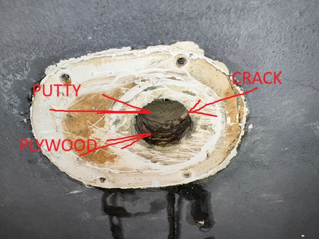

Fig. 3. A view of a hole in the hull after the through-hull was removed, located in the mid-cockpit, looking up from below the hull toward the cockpit.

I removed the bronze through-hull fitting, and there was a little water coming out of the unfilled screw holes for the through hull screen and the place where the putty meets plywood on the bottom of the hull. I pressed on the inside of the drilled hole and the putty was cracked on the uphill side. The hole for the through hull, while on specification with the drawing was drilled only about 1/16-inch from the edge of the putty box, and the the foam on the other side was wet.
I removed enough of the putty that the foam could start to dry. After about a month drilling holes, and applying vacuum, I have the area all dried out, and I am getting ready to replace the through hull, but I want to repair the putty box, and perhaps expand it a bit so there is more putty around the through hull than before. I don't think this is why it failed, but I assume this adds structural support to keep the fiberglass from flexing when the fitting is tightened. I really appreciate it.

The term putty box as previously used on this website refers to a section between the outer and inner hull (liner) where the foam has been excluded and replaced with a material that creates a solid and waterproof area. The purpose of this modification at the factory was to provide an area where a SONAR transducer could be installed using a through-hull method rather than attached to the transom.
The term putty box is not a reference to any sort of sealant applied to a through-hull fitting. The typical sealant used by Boston Whaler is often a commercial product that is not generally or easily available at retail or marine outlets.

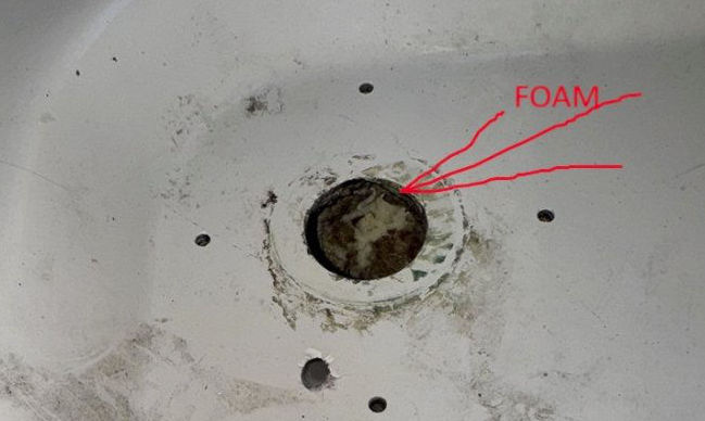

Fig. 4. In this view a red line points to the leaking through-hull hole area from the cockpit view. The nearby foam was found to be holding water.
The small drill holes around the factory drilling for the livewell pickup were drilled by me to help get it dried out. The only one that found foam was the one above the factory drilling. The others all found hard, dry cured putty.
[Repeats original question.}
Q1: What brand and model of "putty" was by Boston Whaler for the putty?
Q2: What available material would be compatible with the OEM putty?
I want to beef-up [the area around the through-hull fitting] before I [re-install the through-hull fitting and] re-seal [the openings] .
Absent advice from someone who has previously encountered and resolved this repair, I think I will use MarineTex [a pre-mixed thickened expoxy sold in various size containers]]
I will let the MarineTex cure for a week or so before I apply new sealant, and then I will re- install the bronze through hull with a proper sealant.

The putty box is used in modern boats as an area for installation of a through hull transducer or through-hull fittings. Boston Whaler fabricated this box out of solid fiberglass.
For your predicament, let the foam dry to the touch.
Coat the exposed foam with epoxy and reinstall a new through hull fitting using a quality marine sealant (NOT adhesive) in the fastener holes and the fitting flanges on the interior and exterior surfaces. Recommended brands of marine sealant include Boat Life or SikaFlex.
It is somewhat known that the factory did not install much sealant in the through hull and transom fittings and it often led to water ingress into the foam.

Thanks for adding four illustrations and much expanded explanatory narrative so that readers now understand much better the location of the through-hull fitting (which is noted as being bronze and passed through the hull bottom) that was leaking.
In this instance the through-hull fittings are much the same as a through-hull SONAR transducer, as in both cases there is a penetration of the hull vertically through the laminated structure of the Unibond hull, with the lower opening being far below the water line and also likely that the upper opening could be just at or also even below the water line. Maintaining a water-tight passage and seal for fittings like this is extremely important.

GorgeWhaler wrote:...I want to repair the putty box, and perhaps expand it a bit so there is more putty around the through hull than before. I don't think this is why it failed, but I assume this adds structural support to keep the fiberglass from flexing when the fitting is tightened.
Based on what is seen in Figure 4 where you added a red line callout that shows the layer below the gel coat in the cockpit is foam, and presumming the through-hull fitting is tightened by a nut on a threaded portion that extends above the cockpit gel coat layer, then on that basis I do not see how the putty box is going to add strength at that point. Tightening the nut would exert a force on the gel coat layer and the foam layer below it. The putty box is (apparently as shown in Figure 4) below the foam layer at this point. The foam will be more likely to be compressed than the cured putty of the putty box.
The wood reinforcement layer located farther down in the hole is positioned just above and bonded to the hull bottom gel coat layer. The purpose of this layer is to provide material so the screw fasteners (which I presume hold a grill in place over the through-hull inlet fitting) will have material into which they can gain strong purchase.
The purpose of the putty box is to provide a waterproof surrounding layer. It seems a bit paradoxical that the putty box does not extend almost all the way to the cockpit gel coat layer. Your illustration Figure 4 shows the foam layer is between the cockpit gel coat and the putty box.

Regarding making a large hole through the hull that exits below the water more immune to having water penetrating the surrounding foam in the interior of a Unibond, a proven technique is to drill the hole or otherwise enlarge the diameter of the hole to be very slightly oversize, apply a coating or two of epoxy resin to the inside diameter of the hole, decreasing its ID, and then re-drill the hole to the proper size. In this method the foam that was exposed is thereby sealed by the epoxy coating, and any water that exists in the hole cannot get to the foam.
Re: Source for OEM Putty as used in Putty Box
Postby jimh » Mon Jun 16, 2025 9:28 am
Note that the reason there is a layer of foam above the putty box in the construction of your Unibond hull relates to the sequence of creating the Unibond hull.
The hull is formed from two separate laminated and molded assemblies. The hull bottom assembly is laid up in its female contact mold, and while the polyester resin is still curing, and in the location where a through-hull fitting is anticipated to pass vertically through the hull bottom, a rectangular area is built up using a material called "putty" which cures to a hard solid form. The height of this material is limited because in the next operation, the hull liner section will be laid atop the hull bottom section, and to create the putty box to the precise height of the distance separating the hull bottom and liner sections would be difficult. After the two hull sections are joint, all space between them is filled with an expanding foam. The entire assemble cures while the two components are still in their molds, necessary to resist the force of the expanding foam, whose expansion is limited in order to increase the density of the foam.
This sequence produces the various layers seen in the hull at the through hull location (as are shown above in Figures 3 and 4). Starting from the cockpit deck level and working downward toward the hull bottom, the layers are:
  1. topmost, the deck laminated layer
  2. foam filling
  3. putty box
  4. wood reinforcement, then lastly
  5. laminated hull bottom.
