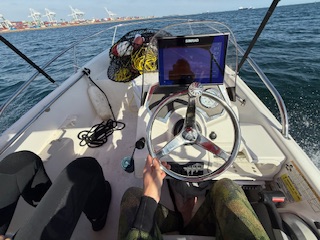

Ever since I have owned my [UNSPECIFIED MODEL YEAR] 2018 130 SUPER SPORT I’ve had wet feet because of the water [that continually] collects in the cockpit. [According to some unspecified source the proper procedure to remove the water is ] to pull [some unspecified] plug while underway for the water to drain--but your feet are already wet at that point. My particular 130 SUPER SPORT has a static trim with the plug just below the line, and, while it will not sink, a ton of "stuff" will grow in the shallow pool of saltwater on the cockpit deck.

Here is the thru-hull with drain plug I'm complaining about. The waterline without anyone in it at the dock is even with the top of the thruhll flange. Pulling the plug while moving seems to be the consensus from other owners of this model and engine package to get it to drain, but I think that is stupid.

And here is the approx. position of the sump relative to the hull. There is about an inch clearance between corners of the sump and the hull although it is hard to tell from photo.

I'll also address the elephant in the room: I was obviously concerned about water intrusion making the hull heavy, but I don't believe that is the concern, as I have compared my boat with others of the same make and model and we have the same waterline. My lil vessel has a 25 gallon fuel tank which does not help.
It is what it is, the waterline is where it is. and I need some way besides my damn hand pump to get the water out.

Postby Jpopsbronco » Mon Nov 10, 2025 8:13 pm
UPDATE after three months of use: I love this modification. I am not sure why Boston Whaler doesn’t incorporate this into their small hulls. It makes cleaning the boat at the dock far less a chore, and really helps keep the boat dry during all the activities we use it for. If someone wanted to duplicate this, I don’t have any further improvements I could recommend.
For example of our use, consider use of hoop netting: as you stack the nets on the bow, all the water the drops off them and runs down the side by the gunwales. This water normally pools at the stern. Without the modification, when the would come off plane, that water would slosh forward and soak backpacks, sandals, dog paws etc. But with the addition of the stern sump, the water just gets pumped overboard.
It’s not like the Sahara desert in the boat, but if I’m wearing leather flip flops, they now stay dry and don’t get wet and gummy--which was not the case before.
FIg. 20 Our 130 SUPER SPORT doing what it does.
