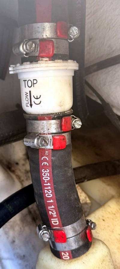

I think a cardboard and foil cap liner may be caught at the fuel fill inlet [check] valve (see Figure 1) since I haven’t added any fuel since it fell into the tank.
Fig. 1. A check valve at the fuel inlet to the fuel tank where the cardboard and foil cap liner may be trapped.

Sakana Seeker wrote:I think the cardboard and foil cap liner may be caught at the fuel fill inlet [check] valve (see Figure 1) since I haven’t added any fuel since it fell into the tank.
Your suspicion may be correct, if the device is a check valve and depending on the timing of the introduction of the cardboard and coil cap liner and the flow of the fuel conditioner. Typically the check valve would open and allow fuel or conditioner to flow past the check valve. But if the foil cap liner just fell in by itself, it probably would not open the check valve. I doubt the device is a filter. Again, contact Boston Whaler customer service for clarification on the nature of the device seen in Figure 1.
Sakana Seeker wrote:Q3: what is the degree of difficulty to loosen hose clamps and get access to [the check valve]?
The screw fasteners on the circular hose clamps can be rotated counter clockwise to loosen them; best to use a hex-nut driver not a screw driver to perform this operation. However, even with the hose clamps loosened, the fuel hose will be very difficult to bend because typically there is a wire-wound reinforcement in the rubber part of the hose. The entire fuel filler inlet on the hull may need to be loosened or temporarily removed in order to move around the fuel hose. A hose of that diameter is not simple to bend or move.
Before trying to remove the check valve, you should lower a small electronic camera or borescope into the fuel inlet fitting to see if the cardboard is actually there. If the cardboard is sitting atop the check valve, you could remove it with suction. Or, alternatively, go fishing with a suction hose to see what comes out.

If you are not having any difficulties with the engine operation or refueling consider ignoring the "problem". If the cap seal has made its way into the tank the cardboard should quickly dissolve. The remaining dime sized piece of aluminum foil should not cause fuel supply problems. If you do eventually have problems worry about it then. A one way check valve in the tank fill hose is to prevent fuel back flow. It's a stretch to believe inspecting it will have any bearing on the matter.
