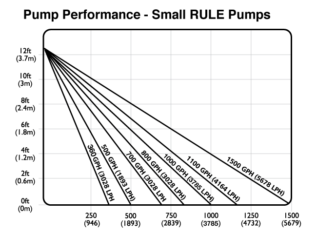

The distance the water must rise in the output of the pump is known as head. Rule provides data about the rate of flow of water from their pumps with various distance of head. Here is the data for a typical small pump, the RULE model 24. The pump is described in the literature as having a pumping capacity of 360-gallons-per-hour, or 6-gallons-per-minute. But that rating is for a head of zero, that is, no water is lifted any distance. The pump is derated in capacity as head increases, as follows, per the RULE literature:
FEET  GPH at 13.6-Volts
0 360
3.3 265
6.7 190
Those ratings are with a supply voltage of 13.6-Volts, which is unlikely to be possible to obtain from a battery unless the battery is simultaneously being charged by some sort of battery charger. A battery that is not under charge and has been subjected to discharge will have much lower voltage. RULE provides ratings for the pump at 12.0-Volts, a typical voltage for a battery in a state of partial discharge and with some voltage drop in the wiring to the pump. The pump rating are then:
FEET  GPH at 12.0-Volts
0 330
3.3 240
6.7 150
RULE does not provide ratings for greater distances of head, and that's because the pump probably cannot deliver much output with any greater distance. We see that with a pump being presented as a 360-GPH pump, in a real-world situation with a modest head of 3.3-feet and typical battery voltage after some discharge, will only deliver 240-GPH, or about two-thirds of the initial rating.
Also, those ratings are most likely for smooth hose with a length not any longer than the head dimension. If you have the typical corrugated flexible hose and the hose runs horizontally some distance as well as vertically, you can expect the output to reduce further.
I have a RULE 500 pump in the stern live well of my Boston Whaler boat. The head on the pump is the absolute least amount of lift possible, just to the level of the cockpit deck then immediately overboard. The hose is a smooth hose, not a corrugated flex hose. I tested the pump by letting the live well fill with water by pulling the drain plug. Then I installed the drain plug, and turned on the RULE 500. It took the pump about 8 to 10 minutes to evacuate the water from the live well.
Cf.: http://lib.store.yahoo.net/lib/kingpump ... lletin.pdf
Here is a graph (from RULE) showing the derating curve with increasing HEAD. Notice how ALL the centrifugal pumps, without regard to their rated GPH for 0-feet of lift, eventually degrade to almost no output when the HEAD increases to about 12-feet.
