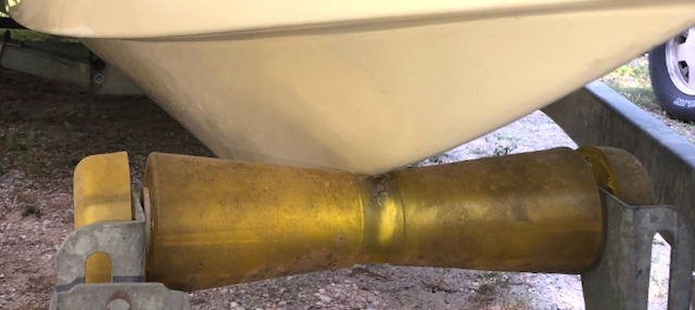

Fig. 1. A yellow polyeurathane keel roller with a sloped shape and a definite center area. I put this style on my boat trailer many years ago in a refit from rubber rollers.
A very useful aid in getting the boat centered during loading is having to tall plastic-tube guide posts fixed onto the trailer at the far aft end. Then control the side-to-side orientation of the hull as it is pulled forward by the winch strap. Also, if the boat ends up slightly ajar from perfectly level on the trailer frame, by the time I tow in ten miles on bumpy roads it always ends up perfectly centered.
The type shown in Figure 1 that has end caps is useful for the most forward roller as the bow stem might approach the roller at an angle and hit part of the mounting bracket.
