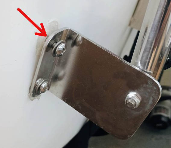

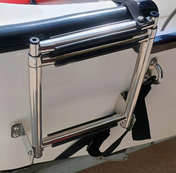

In c.2023 I purchased a 2003 SPORT 150. In 2025 I added a boarding ladder, which I mounted on the Port side of the transom using four #12 two-inch stainless steel screws, threading the screw fasteners though the hull laminate and into the foam. There was no way to use through-bolting and backing plates on the Port side of the transom because the cockpit has a molded-in seat at that location
I wasn't completely comfortable mounting the ladder this way, but I saw no other options. Of course, the obvious happened - the top screws are starting to pull out.

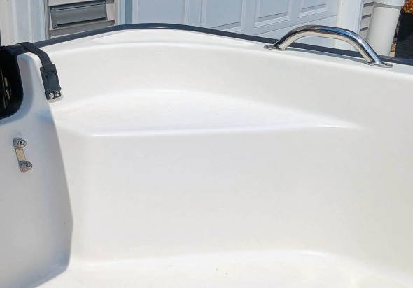

Fig. 1 . A loose screw fastener.
Fig. 2. Transom of boat with boarding ladder
Fig. 3. The molded-in seat at Port Aft of cockpit.
