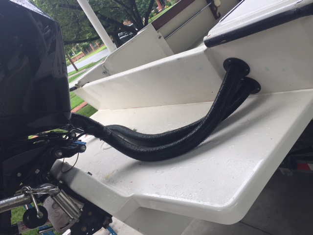

I am also working on figuring out the control routing. Currently I have battery cables and motor cables running down the tunnel on each of the port and starboard sides. The control cables are both in the starboard side. The port side tunnel near the console has a bend that resulted in some binding on the port control cable and so I switched that to the starboard tunnel. The hydraulic hoses are also on the starboard side, and the fuel hoses while not really in the tunnel for long are in the quarter boxes on the starboard side.
I want to get the port side of the swim platform totally clear. I may use simple routing out the rear of the starboard quarter box, or I may also consider having the routing pass through the transom directly into the buoyancy box on the bracket. I need to research that further. I really want to have one side of the swim platform with no obstructions.

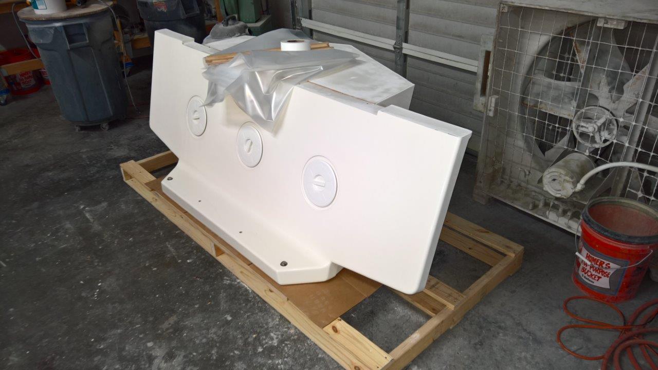

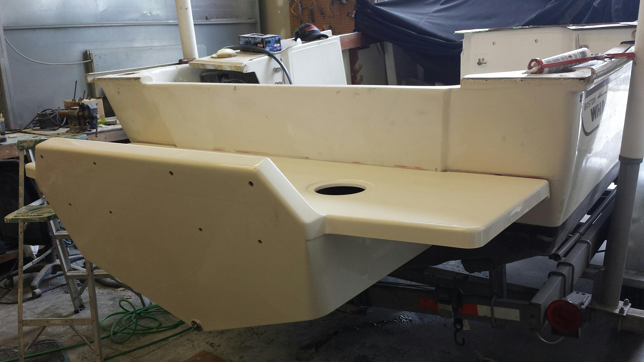

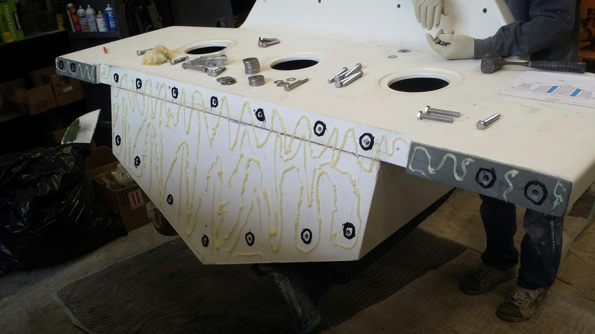

This is a picture of the completed bracket prior to being shipped from Hermco. It should be here later this week. You can see the offset in the swim platform to account for the proud motor mounting area on the Outrage transom.
Re: 1984 Outrage 25: Adding Hermco Bracket
Russell -
Looks great!
I'd consider fully enclosing the transom if you can still tilt the motors clear. If not, you should raise it at least 5 inches.
I'm actually planning to start that modification to my 25 this summer - raising the transom 5 inches and then mounting the "new" 200 HP Yamahas to 6" jack plates. Given the jack plates, I may raise the transom even further - like 7 inches. I haven't decided yet.
Be sure to shoot us photos of the finished project - I'm anxious to see how it turns out!

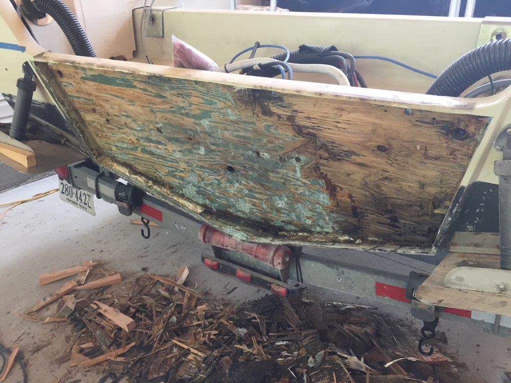

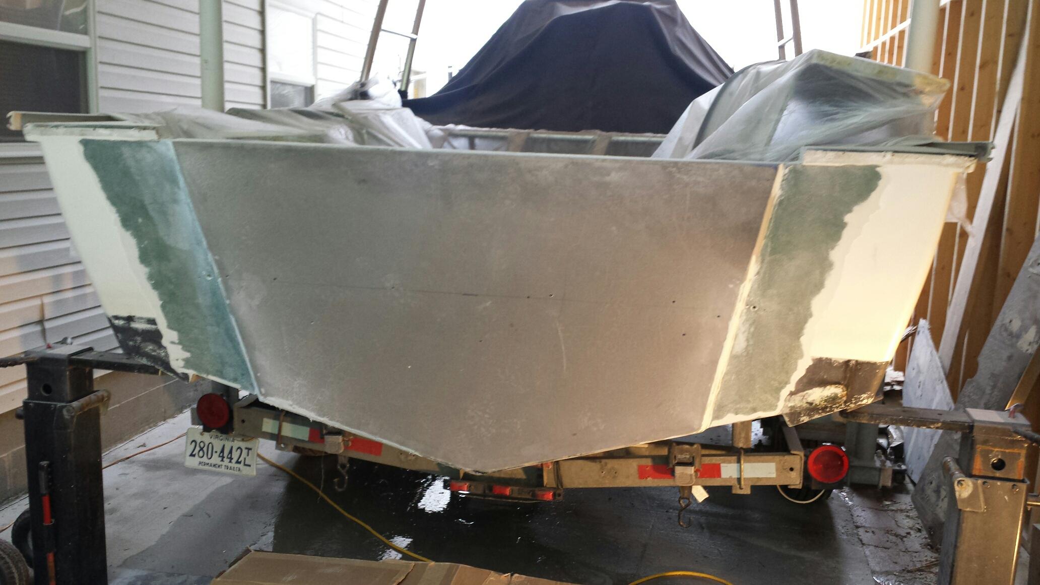

Transom has been dug out. Wood was wet but transom was still sturdy and there were no cracks showing - not bad for 32 years of age. I've decided to raise it to essentially full height, which will be about 12" of additional height. Given its age instead of just adding on I decided to do a full rebuild on the transom.
Other details yet to sort out. And no, I am not doing it myself - Craig at Coastal Fiberglass (coastal Virginia) is doing the work - he has done many transom replacements and I appreciate his expertise.

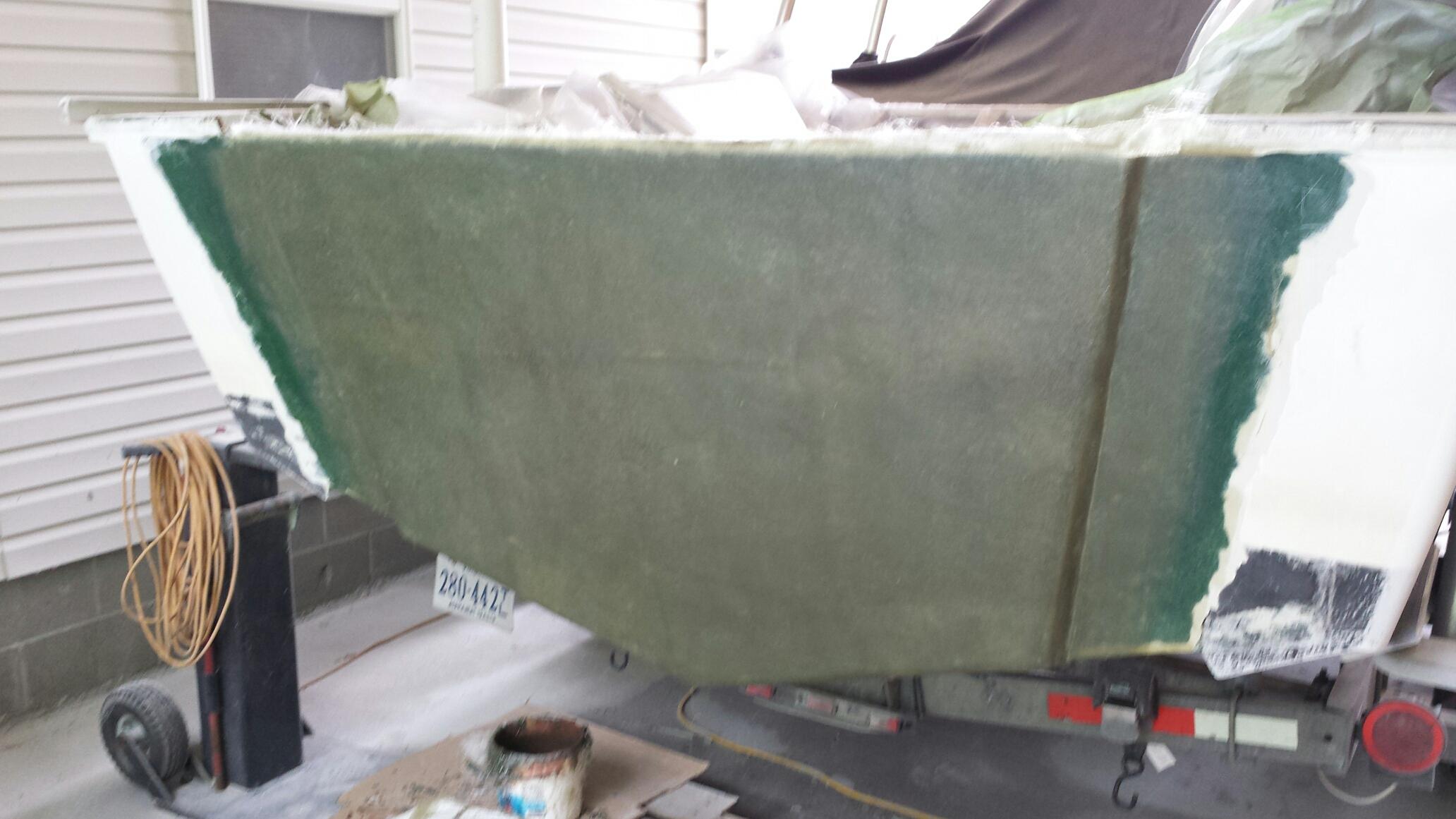

Glassed in
Yet to be faired but structurally fiberglassed.

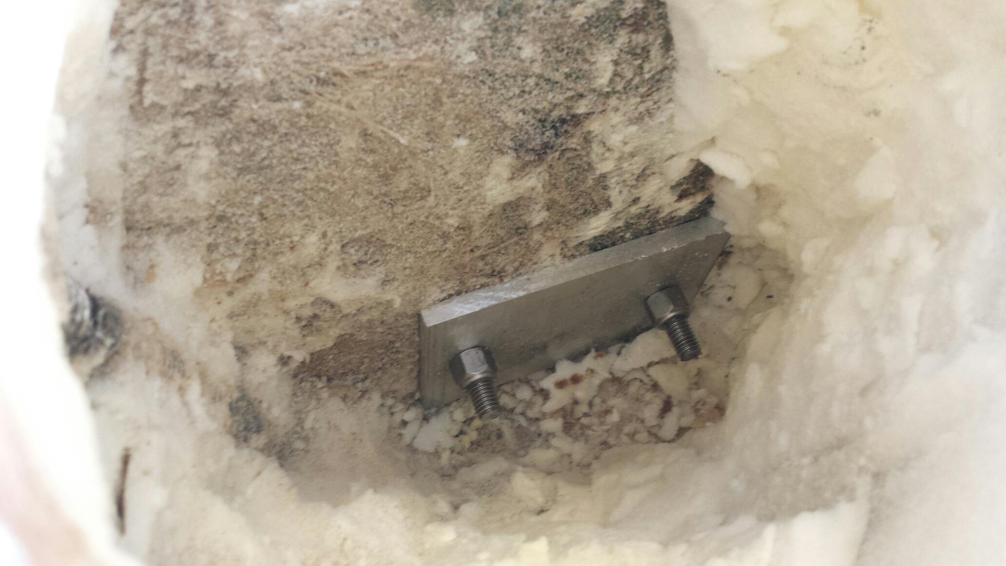

Access holes for lower bolts
As it turned out, the lower bolts for the bracket are well below the splash well fiberglass height and close to the keel. You can see them with the black sealant around them in this about-to-install photo

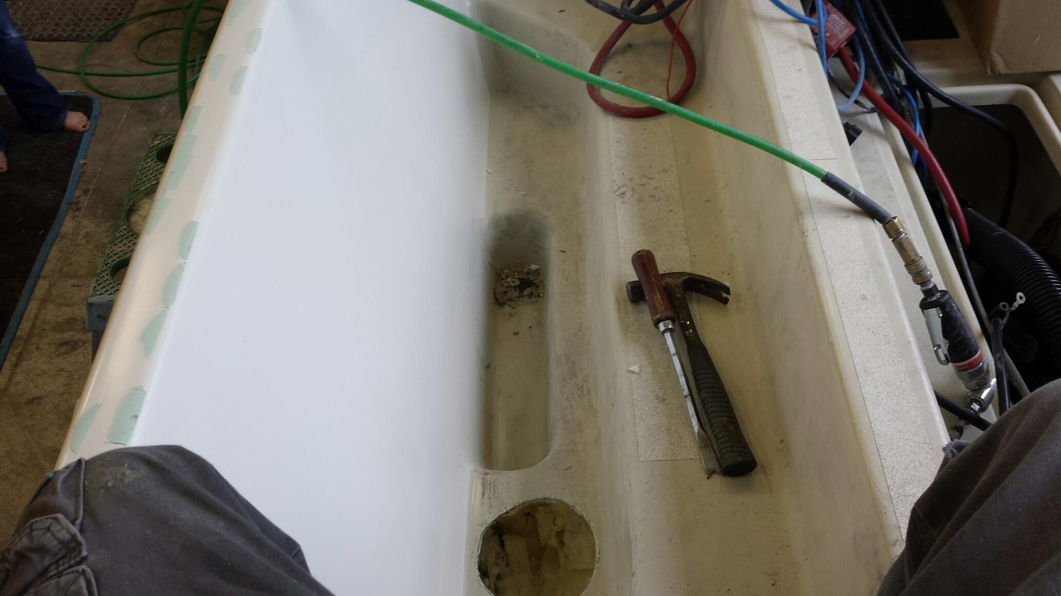

Splash well access
So, the splash well inserts got cut out, and dug through the foam down to the keel. Good news is that foam was all dry down to the last 0.5" or so at the very keel which was slightly damp.

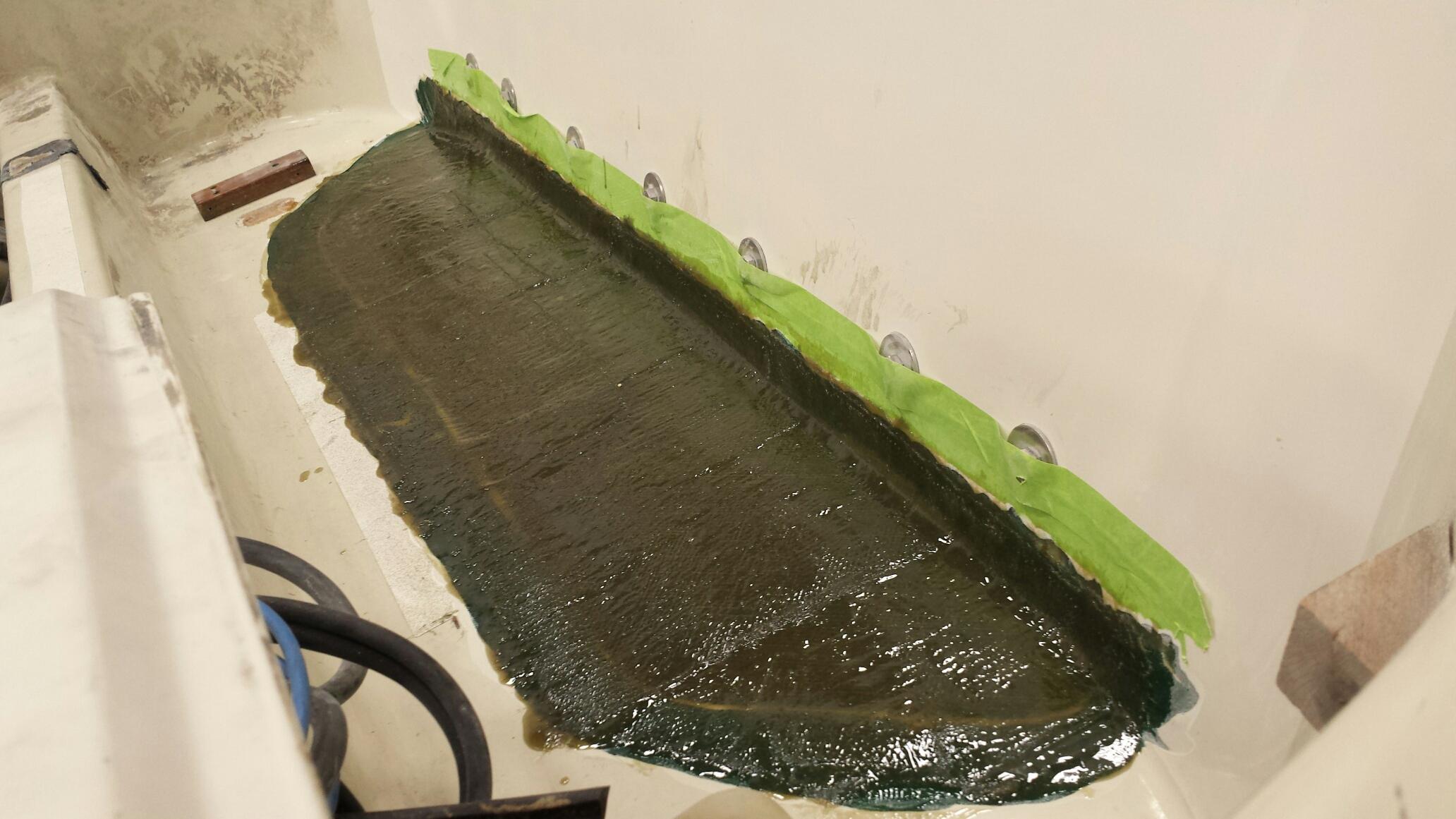

We walk through the splash well all the time getting in the boat, and so decided to level the floor back there with glassing in some Coosa board to make one flat area behind the "dam" that separates the splash well area and the cockpit. That does make the lower bracket bolts not readily accessible, but I can check tightness from inside the bracket and if needed add an access hatch later through the Coosa board.
- image.jpeg (150.92 KiB) Viewed 25782 times

Glassed in
Glass over the Coosa - it will be sanded and gel-coated yet.

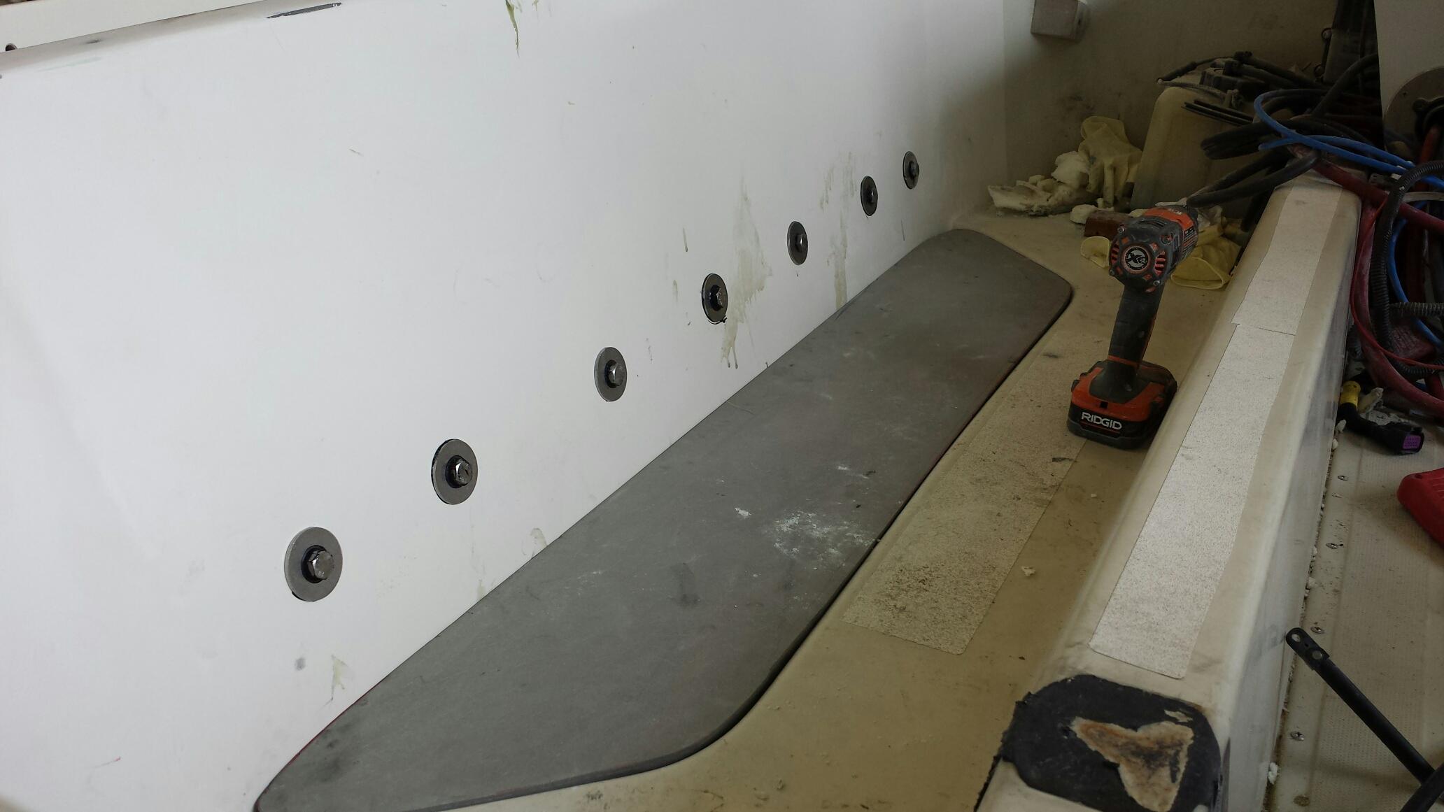

Swim platform bolts
These are behind the quarter boxes in a foamed in area. Rather than sandwiching across the foam, we decided to dig out foam there and through bolt.
This area will be glassed back in.
These bolts are fairly low stress and just hold the swim platform wings in place.

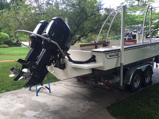

Installed
The bracket is installed, the transom raising is done, and all mechanicals are connected. There is still some cleanup-type work to do (like fastening the quarter boxesand general cleaning), but it is functional for the summer and skilled finish work will not occur until fall.
I'll float it Saturday.

Initial results
Did a brief run at the lake today.
The static trim at the stern corner was two to three inches higher with the bracket than with the jack plates; that buoyancy box has a lot of lift.
Dynamic trim running angle is steeper; trim tabs are useful
Top speed was new record for with arch: 47-MPH

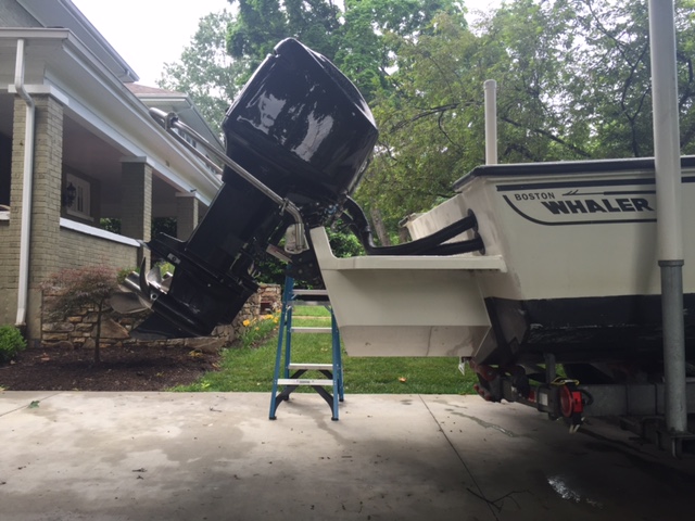

Russell--is the steel tubing around the engines to prevent damage to the engines? I've seen similar guards on commercial and government boats, but only on a couple of pleasure boats. They seem very practical for boats kept in slips.
russellbailey
- Posts: 99
- Joined: Tue Nov 03, 2015 11:03 am
The steel tubing is a Turboswing
We mainly pull kneeboarders and skiers on it. We used to pull wakeboarders on it too but now pull them from the higher attachment point on the arch. The manufacturer told me it was ok to pull up to a 3 person tube on it, but we rarely tube and when we've done so have just done a 2 person tube.
It works great and I highly recommend it as a solution for watersports - much better than a pylon in the boat. And as you noted it has the advantage of a bit of a guard around the motors.
