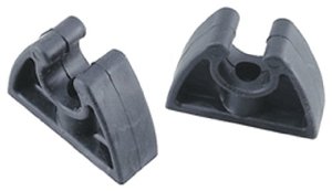

Is there any reason not to fabricate a brace or bracket to steady the pole against the stainless railing around the top of the windshield? Maybe using some rubber pole storage mounts to clip onto the pole and to the railing with a block of wood in between.

Your idea to use a pole lamp storage clip sounds workable. In keeping with the no-wood theme of the 210 MONTAUK, perhaps you would use KING Starboard for the connecting piece from the clip to the frame of the windshield.

- poleLampStorageClamp.jpg (7.68 KiB) Viewed 3939 times

Some great ideas. The picture of the rubber clips are exactly what I had in mind. I was thinking I would use 3 of them, 1 against the pole and 2 on the SShand rail around the windshield. Slip on and off as needed. Nothing permanent. I may try the Velcro straps and a short piece of tube (pvc) as I have all the materials at hand.

I like your idea of using the rubber clips on both ends. That eliminates anything permanent in place when the lamp pole is stowed.
