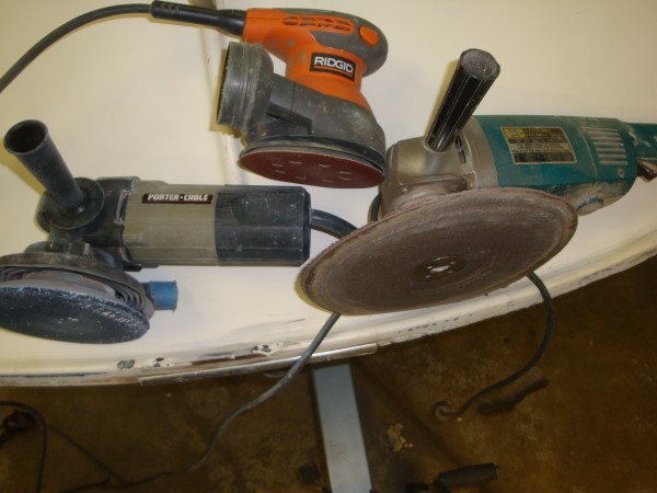

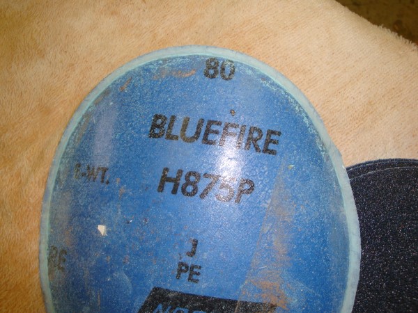

Picture [below] shows my three tools, a Rigid 5-inch variable speed sander, a Porter Cable 6-inch variable speed sander, and a 10-inch disc on a Makita variable speed. The Porter-Cable 6-inch variable speed sander worked the best with an 80-grit disk. It took three hours to do the outside of the hull. I only used four of the disks on the hull--they held up well.

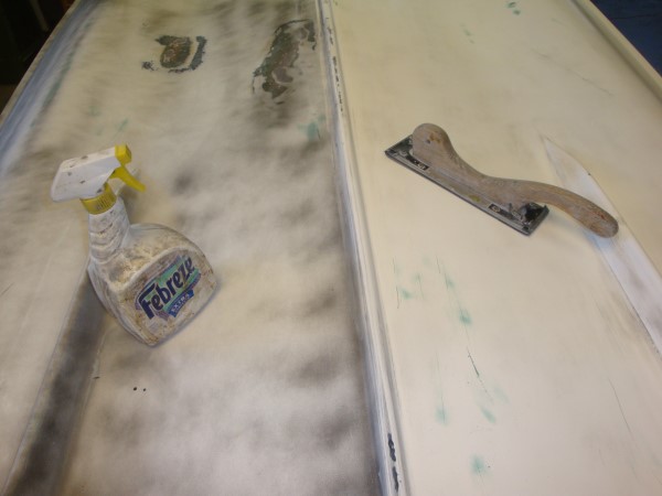

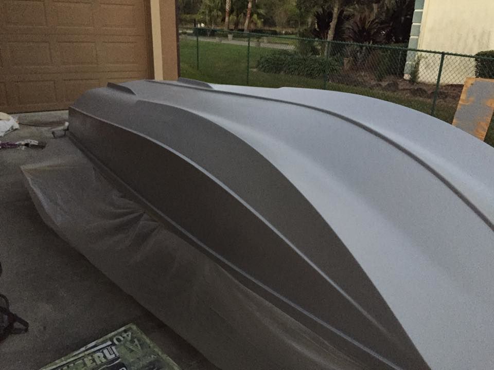

Did some filling today and after the first round of taking the filler down with 80 grit I dusted the bottom with a lite coat of cheap black rattle can paint then proceeded with the board sander loaded with 150 wet/dry and a squirt bottle of water with about a teaspoon of liquid dish washer soap. The soap helps the sand paper clean its self ( I think ) and gets rid of any oil that may be left on the surface. The black paint helps hi-lite the scratches and dings I may have missed.

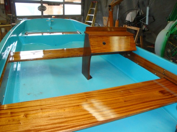

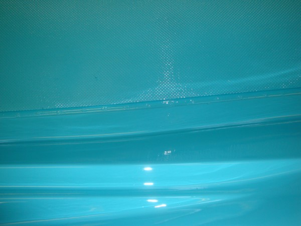

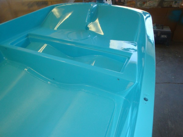

I now have the inside painted. I used the Total Boat Polyurethane and sprayed it using a $19.00 HVLP gun from Harbor Freight. Two coats from 1 qt. of paint that I thinned with about 30% lacquer thinner.
inside paint 2.jpg (47.42 KiB) Viewed 24715 times
inside paint 1.jpg (44.17 KiB) Viewed 24715 times

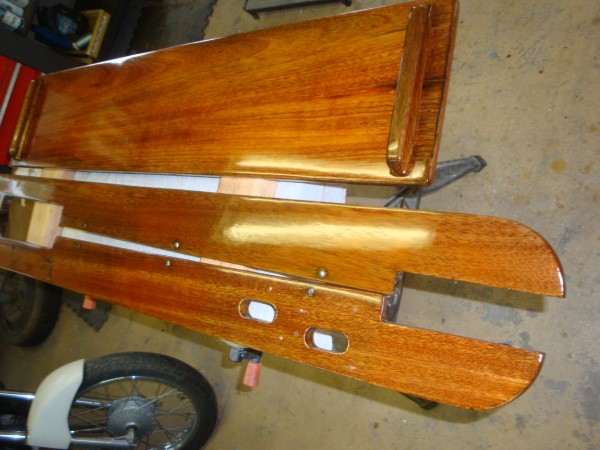

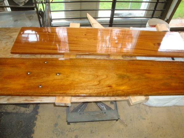

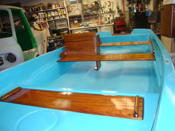

Ive been busy getting ready for winter here, now all the leafs have fallen I can get back to the Whaler. I have all the wood refinished, 7 coats of varnish. The one bench seat was really warped so I got some new Mahogany and rather wish I had replaced all of it noe. The new wood looks brighter, even after sanding and bleaching the old. Will turn the boat back over onto the trailer tomorrow and start putting it back together.

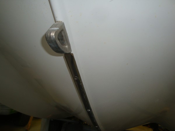

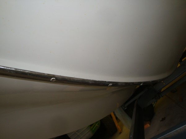

After all the time spent on the bottom of the boat in preparation for paint, I felt some sort of protection was needed. I took a five foot piece if stainless and attached it to the bottom with 1 1/4 " #10 stainless screws. About half of our water here in eastern Washington has Basalt as a bottom, really hard on everything if it is drug across it.
stainless 1.jpg (22.21 KiB) Viewed 24495 times

Interesting on the stainless... Been thinking about a keel guard for mine of some sort. Bought the same paint today myself. Nice to see a photo. Was really thinking about rolling and tipping. Have neve used an actual spray gun and am nervous to learn how to on this project. Already have a decent compressor. Also concerned with turning everything in my garage whaler blue overspray. Maybe I could fashion together a makeshift visqueen paint booth? How do people generally handle this? Going to Dremel out and fair my cracks and crazing tomorrow.

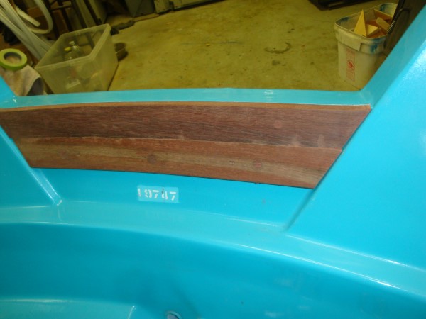

I have the wood back in the boat, and added a additional 6" strip of Karri wood to the inside of the transom. After 38 years of holding onto the engine the transom was showing some compression spots. The Karri wood will stop this as well as help distribute the load across the whole transom. Any one have ideas as to the most useful gauges for the helm ? I'm not really interested in a speedometer, but feel a decent fuel gauge that is accurate and possibly a temperature gauge running off the head. Input Please.

Yes, Total Boat paint was used throughout, As for the foot on the helm two #10 screws into the floor. It seems to me to be fairly ridged.

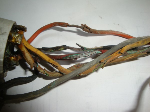

I had hoped that today I could get the wiring done for the lites and Fish Finder. The closest power supply would be from the ignition switch inside the control box, probably needed cleaning anyway. Opened it up and boy what a mess, I have know idea why the ignition switch and all the wiring wasn't completely gone. So I started peeling the loom back towards the engine, and got to about two feet from the female plug that connects to the engine before I found clean and uncooked wiring. I picked up 15 feet of 6 stand at an auto parts store so tomorrow I will rebuild the loom. And yeah both leads to the battery had also been cooked, so they will also be replaced.
Ign loom.jpg (48.79 KiB) Viewed 24114 times

The transom idea with the wood is a good idea, as long as you know its just a temp fix !!! it will not last too long, its a very weak point on these boats due to the stupid way they were built.
the crazy bilge bung idea when they put those in let water in between the two skins and any water in there gets soaked up by the ply transom in between the skins. wood was not soaked in glass before being put in, and no sealer at all around the bilge bungs.

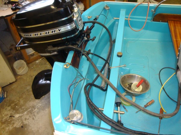

Postby stanyon » Sun Dec 04, 2016 9:57 am

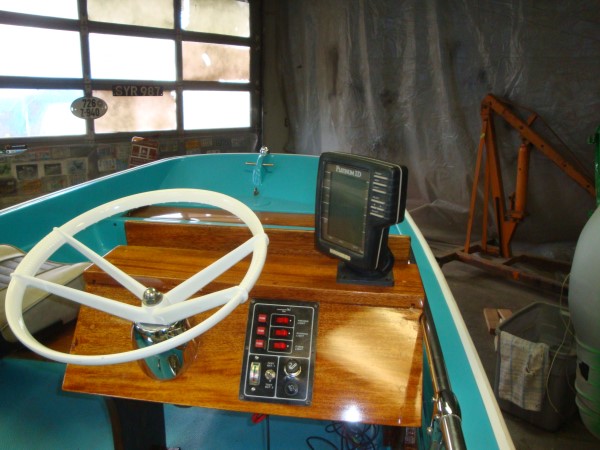

The wiring is finally completed and everything is in place. The last challenge is to secure the cables and wiring in the transom area of the boat.
[Seeks] pictures of this area; they would be much appreciated.
transom controls.jpg (76.84 KiB) Viewed 23948 times
Helm Face.jpg (69.02 KiB) Viewed 23948 times
Posts: 13294
Re: Re-do SPORT 13
Postby jimh » Sun Dec 04, 2016 1:45 pm
It always seem to be a bit of a mess at the transom.
